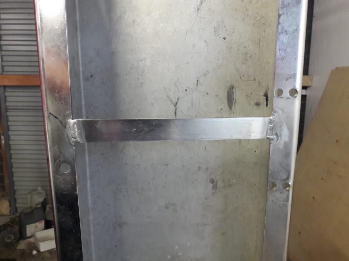

support bar broke on a machine. i had 3 days using the machine with it held together with 2 sash clamps and a pair of vice grips.

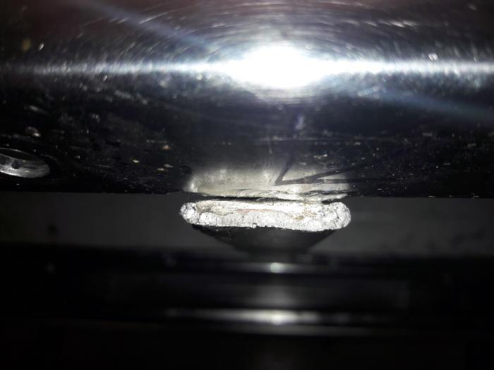

i broke the other end of the bar off by hand, the welds where not very strong.
repaired. not that happy with it. i have nothing to practice with before hand. gas flow was all over the show. found a leak in the quick disconnect. was using aluminum sheet as a backer so its reasonably clean on the back side.
first time using pickling gel. very impressed on how well it cleaned up.

yeah its a bit nasty. i got the neutralizing stuff as well. that way i can neutralize it (most of it) and make it safe to be moved so i can hose it off.weldin mike 27 wrote:Good stuff. Just remember to be very careful with the pickling paste. That stuff can burn right through to your bones, and then eat your bone. Not even joking.
