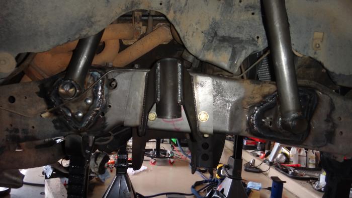

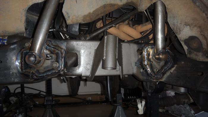

So it's been a long time but I'm not a pro welder nor have many welding projects. I'm currently upgrading my Bronco's suspension and had to do some welding finally! Well I'm still not a pro, but I think I did good enough AND I'm pretty sure the frame will break before my welds do :)
So again, thank you all cuz I wouldn't have been able nor have the confidence to do this if it weren't for Jody and all ya'lls help!
Shock hoop welded in

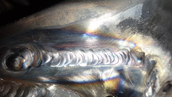

My best bead of the bunch

Looks cool. Hey I'd be interested in seeing more of the welds and see if I or others can't give any pointers. If you're interested.
Looking at this weld here it appears that there is some undercut. Now I don't know much about being a mechanic and upgrading suspensions but if this was being put through some impact stress, it's possible those undercut areas might be a weak area for that kind of stress. I could be wrong since I know very little about what I am looking at in terms of mechanics but I want to throw it out there.

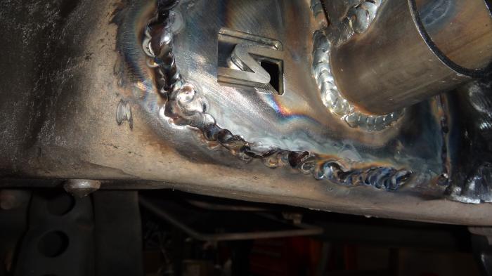

I can get a few more since I don't mind the critique :) It's done so there really isn't much goin back either.
I can identify a lot of issues all around but it was all the skills ya'll taught me to see where I failed and how I could improve as I went along/future. I've learned enough and seen enough to know that this won't kill me too because the root is fully welded, my HAZ is decent, and my failures overall are more presentation/consistency vs. penetration/weld. There's plenty of cut on the brace plate but not too much/deep in the frame which should be good because it's also bolted in and I figure it's better to steal from the outer plate than the frame as I fill/tie things in. There was also some very wide gaps I had to "figure out"..... I know I have some stress points in the frame but I did do a quick "wash" all around to even out the heat stress and of course hide some blemishes along the way.
So that's my thoughts so far and yeah I'll get some pix cuz it'll help me and it'll help others sinceI'm not the first idiot with a torch that knew enough to be dangerous doin a real world welding application ;)

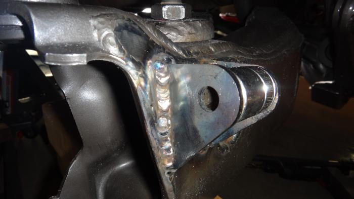

It's almost 1 year since I did this and it's still holding up with no cracks! I feel less scared to share these original weld photos now :D
I get to do some more welding today too...
To the original point, this was my third real weld project and a life critical weld project at that. It's held strong and I've beaten on it and no problems! I'm not for hire cuz I wouldn't qualify BUT for my own needs, I'm happy with the results so truly thank you all for gettin me here :)
