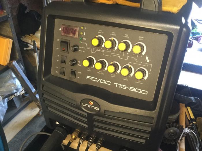

Hi group, just wondering why my tungsten keeps discolouring when AC welding alloy, I have a UniMig Tig 200 AC/DC machine, new, just bought it, using Zirconium tungsten (white tip) just can’t keep tungsten clean on AC, it does ball up but only very small, I’ve clean the job real good and wipe over with acetone, using foot control, and while welding it crackles ever now and then, machine has AC balance, have tried adjusting but I haven’t gone too far either way with it, 10-80 balance adjustment but have only used it from 30-60, thought I’d post on here before I tried anything else. Tungsten goes a dark gray colour and looks a bit crusty and won’t ark when this happens. Thanks guys, cheers

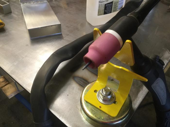

Things are coming together quite well, tungsten staying clean and welding is ok too, more practice and I’ll be there, thanks to you all who took the time to reply and help me out. A couple of pics
- Tungsten looks good
- image.jpg (34.62 KiB) Viewed 2045 times

Thanks tG, I ended up with 50% EP, went from a #8 cup to a #6, and the biggest diffence I found was going from a 0.8% Zirconium tungsten (white) to a 2% Lanthanated (blue), wow made a big difference, stays super clean and balls up perfectly, love it.trainingGrounds wrote:That's great. You won't have to have as much EP balance if you clean the weld area prior to welding. Too much EP balance may cause the aluminum to spit back onto the tungsten given enough amperage. For practice it's not necessary to clean the weld area but for production it's the only way to get consistency for a lot of welding and the best use out of the tungsten.

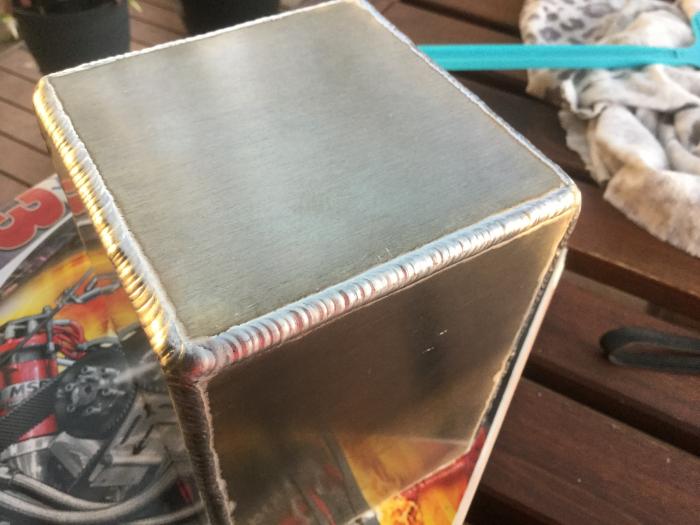

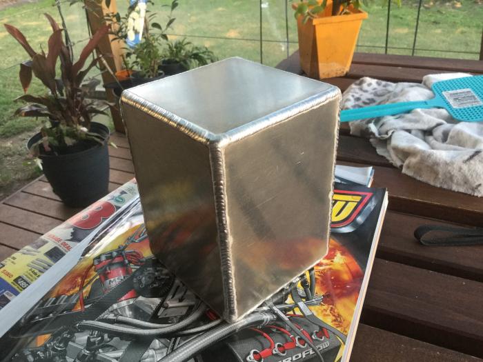

Had some pieces of 5052 alloy kicking around so I made a box last night for shits & giggles
Just have to work on the finish of the weld
- image.jpg (45.53 KiB) Viewed 1991 times
- image.jpg (63.44 KiB) Viewed 1991 times
Location:Orlando FL
Looks good, always used Zirconium for critical AL work, this was before inverters were common, now I use 2% lanthanatedDennis Hrvatin wrote: Thanks tG, I ended up with 50% EP, went from a #8 cup to a #6, and the biggest diffence I found was going from a 0.8% Zirconium tungsten (white) to a 2% Lanthanated (blue), wow made a big difference, stays super clean and balls up perfectly, love it.
