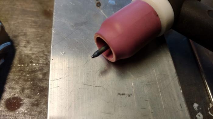

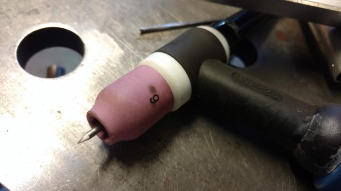

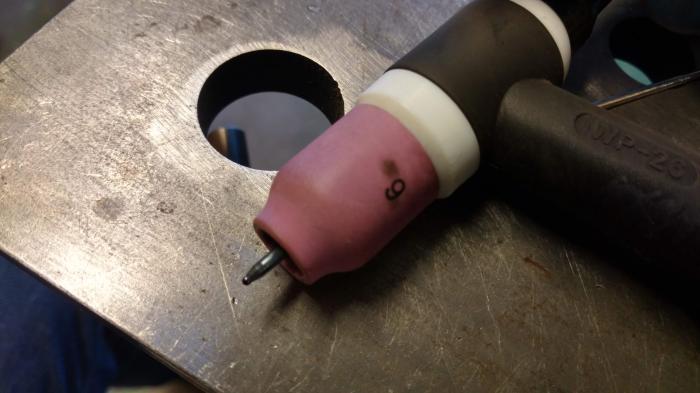

The top tube is a ø22mm x 1,5mm welded to a 30x30x2 angle. i included a picture of the tungsten before and after the welding.

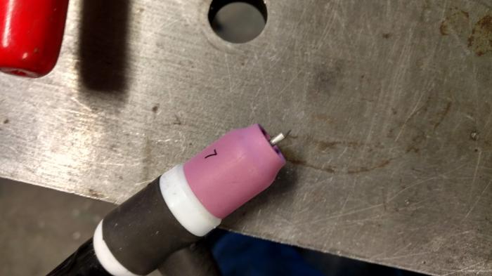

Are you using a gas lens with your setup? Your picture shows a pretty long stickout for a #6. I don’t have a problem with the taper you’re using. I either use a #8 with a gas lens, or a #5 collet body, no lens. Either will work fine in the examples you posted.
I’d also suggest a smaller filler wire. Looks like you’re using 1/8” where 3/32” might be easier to control.

the ball on the end says it all. it should not ball like that. the tungsten is to thin for the amps at the end.
really need to square off the tip. just cut the ball off and it will be about right.
with aluminum you want a 'crayon' tip.
typically i will use a lot blunter grind (45 to 60 degree on thicker material). the arc comes off the SIDE of the tungsten, so the sharper the grind the wider the arc (but better starts). the blunter it is the more focused it is which is better for higher amps.
for the amps used on thin material, a sharp grind is ok, its just the tip needs to be blunter otherwise it just melts and balls, then your arc wanders all over the show.

there is a big difference between balling and rounded tip. a tungsten will always round the tip but balling (ie it has a soccer ball on the end) means the tip is getting over heated.

I think I'll try to take the cleaning action down a notch. I maxed out on that.. I think the balling will be less then.
I'll grind it a bit more blunt tip.

everyone has their own preference. most of the time i run a 8 gas lens. tho i do also have a 7 long gas lens.
the bigger sizes allows for longer stick out which i like so i can see better and get into tighter spots.
doesn't mean 6 won't work fine.
but if there is a question of gas coverage issues, then going up in size can help.

Below a #6, a gas lens is superfluous. A 4 or 5 can work well in tight spots, or a larger cup with longer stickout and a gas lens. The lower your balance, the more your tungsten balls up. I run 65-70% max because I seldom find really clean material and prefer those results. Everyone and every machine differs- experimentation is the key to finding what works for you, in your given situation.

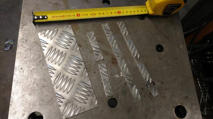

2mm diamondplate. Made it as clean as a could.

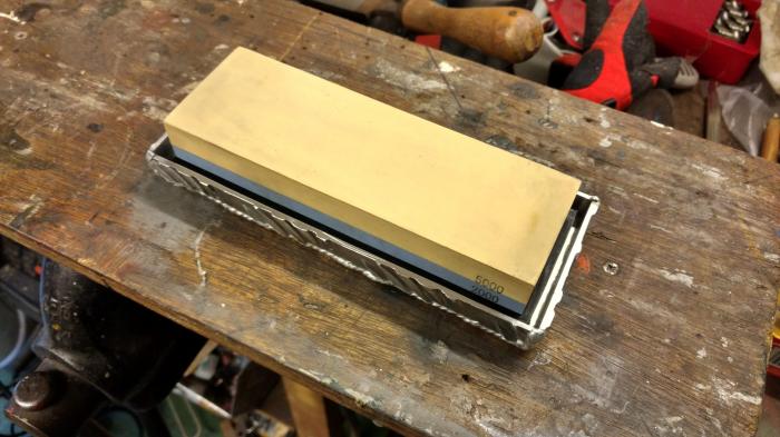

The result. After the first long side i deburred the other even more. I also got to hot on one side, the weld flattned out and started to look grindy. Took my time on the other side. Quenched the container three times. Stil some peppers in the pudle. The shortest sides to the open end went horrible. I think i cut some corners in the setup. This rusulted in a foulty torch angle i think. Even got a snotty filler rod. :(
Even though i think it will work fine as a whetstone container.

Hey - it's not going on instagram but as a start off project looks good - you obviously have the basics down so I think seat time is all you need to improve - only comment is looking at the front panel picture you have post flow to minimum & higher amps on aluminum needs more - most of those Chinese sets only give 10seconds max so wind t up & hopefully the tungsten will look better as its kinda discolored - this oxide layer formed each time you stop hinders good arc characteristics on subsequent starts - also the cleaning action appears way round clockwise - most Chinese welders like yours have 50 / 50 with the pointer around 12 oclock so you usually run them around 10 oclock but yours could be the reverse of this .

nice 8-)
was that with high pulse ?
checker plate i think is a handy teaching tool. because it varies from thick to thin as you weld along, you really have to watch the puddle and watch your heat. its not as easy as flat sheet.
tungsten point looks better. usually i will nip the tip off so it looks more like what you finish with. that way you don't blast the tip off when welding and you end up with a tungsten inclusion in the weld.
