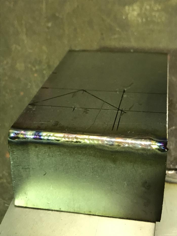

Here's what we managed so far:
1) Half-closed corner, with the top sheet covering half of the body thickness. No filler.
Outside, polished with bristle disks
Inside, passivated
No back purge, just copper chill bars inside and outside
2) Open corner with no gap, with just the sheets edge making contact. No filler, low pulse.
Outside, passivated
Inside, passivated
Sample 1) has many dips/gaps. Sample 2) seems better but maybe we need to increase pulse frequency and travel speed.
What do you think?

I would go with sample 2 AND purge the inside. Purging it will help eliminate the weld bumps a little.
The copper chill bars are great to help control distortion, but do nothing for eliminating contamination.
After welding the outside, you could still come along the inside and "wash" the inside welded seam with no filler, full pulse and that will blend the corners. I don't know if you want a square inside corner, but washing does prevent a "trap area".

cj737 wrote:I would go with sample 2 AND purge the inside. Purging it will help eliminate the weld bumps a little.
The inside would be perfect if it could resemble a fillet, where you can't see any dip or "trap area" as you called it.
But full penetration with no bumps would be a great start :D
Thanks for all the advice you've given. I'll contact our supplier next week for the gas lens!

diasim wrote: I forgot to mention an important detail: we use a shearing machine to cut the pieces. Should we deburr the edges before welding?
Here's some 11ga (nearly 3.2mm) stainless that was sheared, open root, fuse welded. I recall being right about 94 amps, 1.2pps, 50%, 25%, #12 cup, 3/32 2%. On the inside, I clamped 2"x2"x0.25" aluminum angle (a la Coldman) because this was a letterbox.

This was 1.2mm.
For 0.8mm I would set to 34amps and use the peddle to adjust as I go.
I also prefer a number 12 gas lense cup for these outside corner joints. I use the fupa cups from Jody’s weldmonger store.
Sheared edge on 0.8 should be fine without deburring. You’re going to fully penetrate anyway.
With the aluminium angle clamped firmly right into the joint you are not going to get a fillet type bead on the inside but you will get a complete shiny joint if you do it right. Practice first and fine tune your settings. Every power source is different.

Coldman wrote:This was 1.2mm.
Thanks There is almost no discoloration on your weld, good job.

Definitely mill it to a corner. That’s why I suggested the extruded aluminium angle. It has a sharp corner to fill any voids without the need for machining.

Quick and small update for anyone interested: we did try to mill the jig to an angle but the end result was not what we require.
We actually made a small chamfer on the edge, so that the weld pool can "collapse" on it and take its shape,
Meaning that our product will have a chamfer on the inside, if we manage good penetration.
Besides, we cleaned and polished the parts way better than we did before, and now the inside of the weld looks very shiny with almost no discoloration, even without back purge :D
Amperage ended up slightly above 30A with a 1/16" tungsten.

A. <Make the "U" piece 15 x (23 + 15 + 23) + an "L" piece 15 x (15 + 23)> Now have 2 x (15 + 23) = 76 inch weld length (71.7% of original design)
B. < make a box/pan shape fold up so only 4 each x15 inch seams need to be welded> 4 x 15 inch = 60 inch weld length (56.6% of original design) {this will involve some tight tolerance sheet metal bending, so may be too hard in practice}.
Best of luck,
Lee
Thanks for the suggestions!
A. Unfortunately that is not possible as we already made the fixture to weld as per our current design. Besides, making an L+U design will require two different fixtures, whereas we can currently use the same jig for both top and bottom welding
B. That would be the best solution, but consider that the final product dimensions will be bigger than the sample we're making now. We do not have the machines to work with the resulting dimensions of a folded box :|
Anyway, this is the inside of one of the pieces we made while testing various parameters:
Not the best one but for us progress is noticeable! With the dynafile i hope we'll get to the final result we need.
