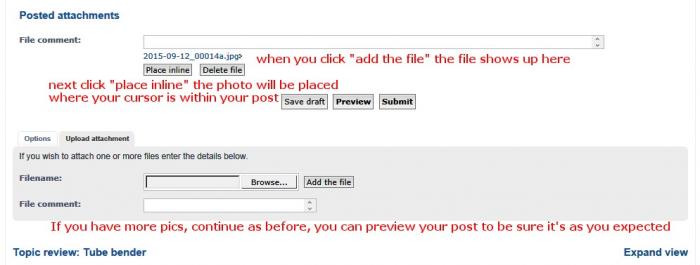

How do I make pictures show up? It's not clear... I'll try again

Steve, maybe this can help...Stevegannonhandmade wrote:How do I make pictures show up? It's not clear... I'll try again
[img]https://i.imgur.com/FumWqSF.jpg/img]
- uplaod 1.jpg (13.54 KiB) Viewed 2775 times
- step 2 upload.jpg (21.13 KiB) Viewed 2775 times
you left out the [ on the code.
this is the pic. https://i.imgur.com/FumWqSF.jpg
edit: pic is to big to display on the forum. the above link should send you to it.
