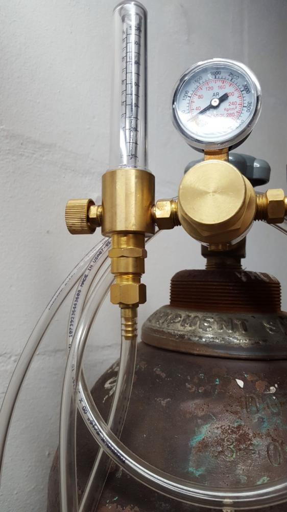

I find the gas hose used for TIG machines too big in diameter (and heavy) for purging, here is my setup using the clear tubing that's very flexible available at the local big box store

Interesting. That plus a small ball valve for the purge and I'm set. But is that hose even close to 2500psi rated? Or does it not matter? I've got a big spool of that stuff I think.
Most flow regulators take the pressure down to about 50psi. It’s probably stamped on the regulator or you could check it with a second gauge.
This is a dual flowmeter I bought from USA Weld, as Josh said the regulator reduces the pressure, so the hose only sees what you set the flow meter at.

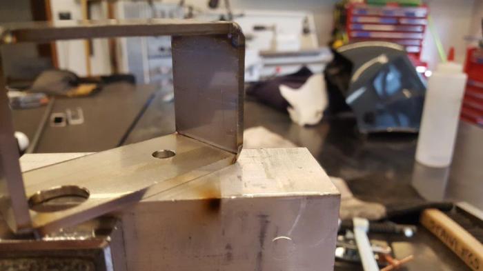

I did manage to find a little piece of alum angle and did a quick test weld on a little scrap of mystery stainless. The setup is a half-lap corner (a BS tech term that?!) ... meaning the top piece is about half covering the vertical piece. I'd rather line up the inside corners and squirt some filler to fill in/round over the edge
Attached the evidence. (don't look too closely at my bead, I had a seizure!) :roll:
I have to say my brain says it'll stick to the aluminum if I saturate the weld with enough heat to get full penetration, so I scooted along at a furious pace. Got close to full penetration, but as you can see, not quite.
Is that a legitimate concern or should I just take off the Depends and weld like a big boy?
Settings were approx 105amp, pulse at 35% background current, 37% on-time, and 1pps... argon at 20CFH.

Looks good. Whether it needs to be full penetration depends on the forces it’s going to see as well as the direction the stress will be applied to it.
Bikesquid
    Wed Feb 28, 2018 5:41 pm
Yes, but the question is IF I do full penetration will it stick to the backer?
If it’s ss on an aluminum backer then it’s possible to melt through enough to get it to stick a little. But unless you really over cooked it (from the look of your beads I doubt that’s a concern) you can just bump it free with your hand.
As Josh said it could stick, but it would come loose with a light tap, other option is to run a bead from the back side.

LtBadd wrote:run a bead from the back side.
Yes. This. Unless you absolutely can't get the torch inside, it's waaaay easier than trying to go full penetration without a gap or feather edge fitup (and those aren't easy to do well as a beginner either).
Let it cool in between frontside and backside passes and you shouldn't discolor too badly. Clean it with a stainless wire brush and you should be good if you did it correctly.
