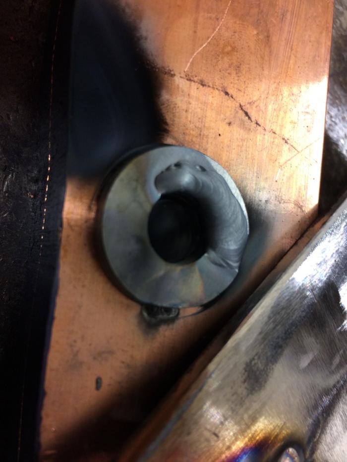

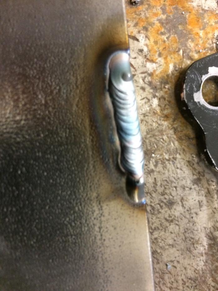

I'm trying to weld some washers to 1/4" plate and my first attempt left tons of black stuff and popping of the washer metal as I was melting it. So I try just the 1/4" plate and weld it on the edge using 33 PPS. Still leaves some black around the edge. I had just got a new bottle of argon and I thought maybe my argon wasn't good. So I take the argon bottle and roll it on the floor for 2-3 minutes in case it wasn't mixed right (heard Jody recommend this), and then I welding next to the edge where I'd previously welded (after wire wheeling the previous weld to get rid of any junk). Much better but maybe still some on the edge. Now I'm questioning my 1/4" plate, so I go get another old coupon I had and sand it bright and shiny and much better with that weld, perhaps a bit of discoloration at the end, but each "dime" looked pretty shiny to me (BTW, I'm using the Fupa 12 on this w/25CFH). So then I grind the zinc off a single washer and using the 33 PPS weld on it and it leaves a trail of black everywhere. The washers were supposed to be carbon steel but who knows? Obviously can't use them. Still wondering if my argon is good.

If they are zinc, don't weld with them. Take the zinc off, period. Grind at minimum, but it's hard to get it all off. Easier to soak.Goldhawg wrote:So then I grind the zinc off a single washer

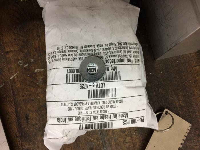

Sure, they're carbon steel under the zinc, but if they are plated you shouldn't weld them. Must be because they are French, Hencho in India...right on the package.
You shouldn't breath the fumes from any zinc. Carry on at your own leisure.

It’s the washer causing the issue. Like stated before it looks like it has a zink coating. It is pretty common for most washers to have a coating to help prevent corrosion which usually makes them difficult to weld. Try and grind all the edges and the faces of the washer and try again, I bet you’ll have better welds. If it was your argon you would have all kind of holes and blisters in your weld.
Except it is happening on plate steel in other examples.Graveyard wrote:It’s the washer causing the issue. Like stated before it looks like it has a zink coating. It is pretty common for most washers to have a coating to help prevent corrosion which usually makes them difficult to weld. Try and grind all the edges and the faces of the washer and try again, I bet you’ll have better welds. If it was your argon you would have all kind of holes and blisters in your weld.
It appears to me to be an issue with your gas flow/gas lens. Are you using the correct insulator with your Fupa cup for your torch? And which brand of gas lens are you using? I used to use CK lenses, but switched to Millers after having some issues with inconsistencies and have found the Millers to actually be much better (personal, anecdotal experience)
Last thing which may be obvious, after welding some zinc plated material, did you regrind your tungsten and clean it? Fouling of your tungsten from the chemical blowback will contaminate your arc.
The way I was reading it, he didn’t use a washer on that weld, maybe the OP could confirm if he did or not. The description sounds like contamination, which zinc would do. Also he mentioned when he ground the edge of the washer it was better. You need to get all of the zinc off if it’s there I thought ???cj737 wrote:Except it is happening on plate steel in other examples.![]()

It very well could be a gas flow issue but clearly the soot on the washer is far worse than on the weld examples. I have had contaminated argon before and you can’t even weld with it and that was the point I was trying to get across. the argon looks to be fine. And I was offering a suggestion as to why the washer welds were worse than the other examples.
I agree, your tank is fine. The fact that the washers weld up poorly is due to the Zinc coating. Even once you grind it, unless you grind ALL of it off completely (the inner ring and edge too) it will still contaminate your weld. In my view of these limited pictures, its: your weld looks contaminated, the zinc-effected look really worse. Which as I said, is not surprising to me.Graveyard wrote: It very well could be a gas flow issue but clearly the soot on the washer is far worse than on the weld examples. I have had contaminated argon before and you can’t even weld with it and that was the point I was trying to get across. the argon looks to be fine. And I was offering a suggestion as to why the washer welds were worse than the other examples.
As a test, swap lenses, tungstens, and use a clean piece of steel and see what happens.
