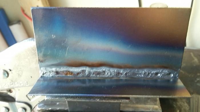

Here is the front and back of a weld. I'm concerned about the back side of the weld. Please observe and comment.
Using mild steel 18 gauge with a 9 torch 1/16" electrode.
Thanks,
Dennis

I was using 1/16" rod. I do have some .045". I'll give that a try. By the way, I was using 67 amps. You have addressed my problem area. Thanks
Dennis

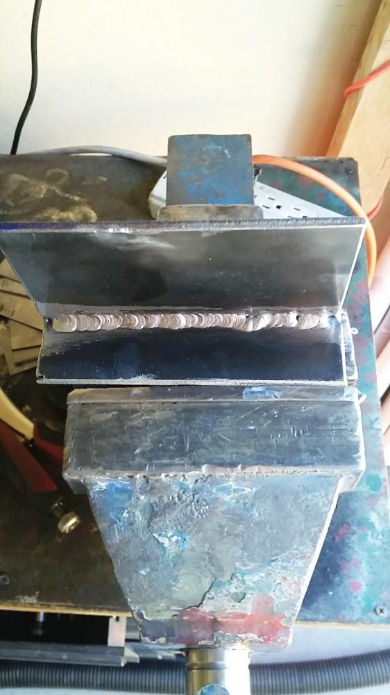

p.s.
I have done a similar weld on 11 ga (.122") and here are pictures of both sides. This joint material is 2.5 times the thickness. I used 100 amps with a 3/32" electrode and 1/16" filler rod.
Dennis
