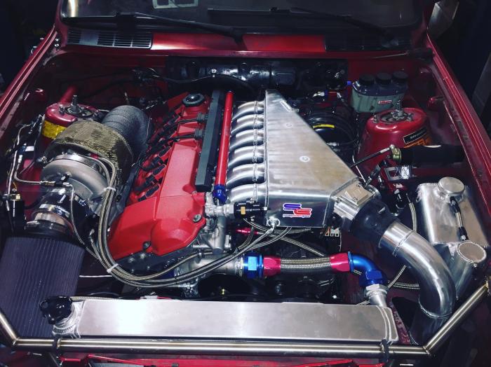

Does anyone know where to get this TIG rod online for a good price? I've looked around my favourite retailers and they've never heard of it. I need to weld to a stainless turbocharger housing.

Borg Warner engineer in charge of the IndyCar program and confirmed through Lincoln Electric, yes high carbon deposit designed for high temperature operation, exactly what I need and want. Thanks though.
