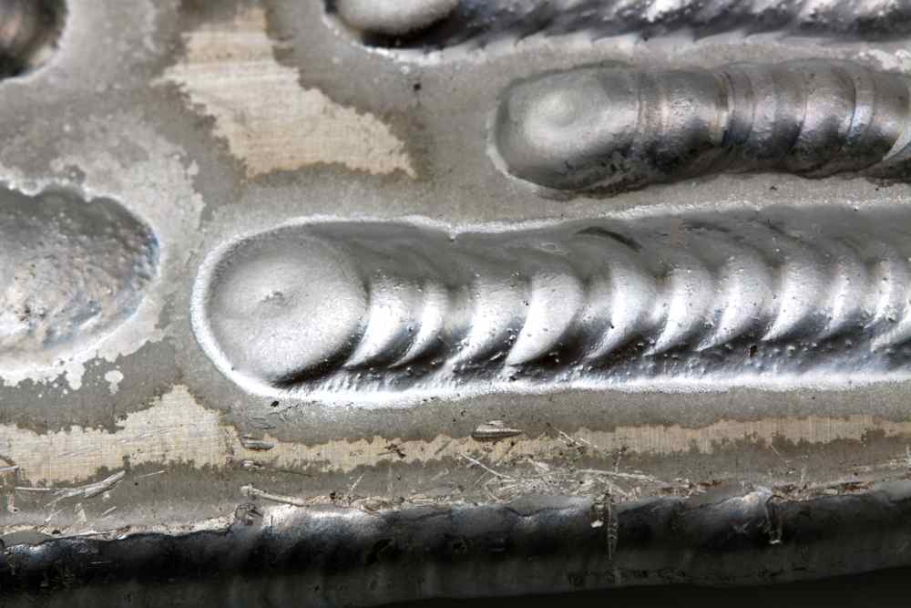

HI GENTS,
I AM NEW TO THE SITE BUT SEEK SOME OF YOUR INSIGHT. I HAVE DECIDED TO LEARN THE ART OF TIG WELDING ALUMINUM AND I AM HAVING FITS!!!!! I HAVE NO PROBLEM FORMING A WELD POOL WITH THE TORCH (ALL SHINY AND NICELY FLOWING) BUT THE MOMENT I TRY TO INTRODUCE THE FILLER ROD, THE POOL TURNS TO CRAP. THE POOL TURNS BLACK AND THE FILLER ROD BLOBS INTO THE POOL LIKE BLACK SUT. I RELIGIOUSLY CLEAN MY ALUMINUM AND PREHEAT WITH A TORCH PRIOR TO WELDING, I HAVE VARIED MY ARGON OUTPUT FROM 10-20 ON THE GUAGE, I HAVE HAVE CLEANED THE FILLER RODS (TRIED 3/32 AND 1/8 4043). I AM GETTING VERY DISCOURAGED. ANY INFO WILL BE GREATLY APPRECIATED.

BUZZMAN4177,
I hate to ask what's probably an obvious question, but you're using AC high-frequency (and you know it's working), 100% argon?
Are you certain of the alloy of your base metal?
With the cleaning you describe, the gas flow, and the fact your puddle forms normally, something doesn't add up.

THANKS FOR THE RESPONSES. I HAVE BEEN A FAN OF JODY'S SITE FOR QUITE SOME TIME AND I HAVE WATCHED EVERY VIDEO HE HAS YET TO PRODUCE. STILL CAN'T GET THE BLACK SOOT TO KEEP FROM FORMING WHEN I ADD FILLER METAL TO THE PUDDLE. I HAVE A RILAND 160P WITH PULSE WHICH DOES GREAT WELDING STEEL. I HAVE IT SET ON AC AND HIGH FREQUENCY ENABLED. AS I MENTIONED, I HAVE NO PROBLEM AT ALL FORMING A GOOD, SHINY WELD PUDDLE, IT IS JUST THAT AS SOON AS I INTRODUCE THE FILLER ROD THAT THE PUDDLE TURNS BLACK WITH SOOT. I HAVE TRIED DIFFERENT MAKES OF FILLER METAL AS WELL AS 3/32 SIZES AND 1/8 INCH SIZES AND STILL THE SAME THING!! I AM WONDERING IF THE FILLER ROD IS OBSTRUCTING THE ARGON (100%) GAS FLOW? ANY TAKES ON THIS WOULD BE GREATLY APPRECIATED.
How much gas flow? With too much, it's possible pushing the rod into the flow is creating turbulence and mixing air in at the weld, even drawing it along the backside of the rod. In calm air, 10-15 cfh is plenty whether you're using a gas lens or collet body. The only time I've needed more than 30 cfh was with a 12 cup, outside.
Also, the smaller your cup, the less flow it takes to get turbulence.
I'll be interested in the solution to this one, as it's new to me.
Steve

FIRST OF ALL GENTLEMEN I DO APPRECIATE YOUR RESPONSES. WENT HOME LAST NIGHT AND REMOVED THE GUAGES ON MY ARGON TANK AND REPLACED THEM WITH A DIFFERENT SET OF GUAGES....TRIED TO WELD THE ALUMINUM AND GOT A PERFECT WELD WITH THE FILLER METAL. I PLACED THE GUAGE ON ANOTHER TANK OF ARGON AND TRIED IT AGAIN....SAME THING HAPPENED AS BEFORE...SO I HAVE COME TO THE CONCLUSION THAT THE GUAGE IS BAD. I COULD HEAR THE ARGON HISSING SO I ASSUMED THE PRESSURE WAS WHAT I HAD SET IT TO ON THE GUAGE. VERY GOOD LEARNING LESSON FOR ME. AGAIN THANKS FOR THE IMPUT GUYS. TERRY.
So you're using a regulator set, instead of a regulator/flowmeter?
It sounds like my guess about gas flow was pretty much on target. (And it was a guess!)
What's your city/state? I have access to dozens of used flowmeter sets, and could send you one for the postage. You'll use a lot less gas when you can precisely control the flow.
Steve
Steve
Two possibilites and I think you've found one. Your gauge set or your hoses are sucking air from leaks. The other thing that will help keep your welds shinny while maintaining penetration is to keep the filler rod close to the torch and covered by the gas envelop.

I had a similar problem, when I was welding aluminum and I kept getting monkey turds. I finally figured out that I had bad/wrong/contaminated gas. After I switch to a new tank of argon it was all was good. Here after and before...I should have cleaned the top plate but I was just testing on some scrap.
Gas flow 20, 100% argon, 6061 alumimum, 3/32 filler rod, 3/32 2% CER-T, using a Miller Diversion 180 @ 100 A.
