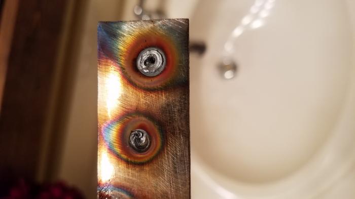

Hey everyone. I just got a Lincoln Squarewave TIG 200. I got it set up and did some welding with it today. I've done very little tig welding so I'm trying start the learning process. I had a few problems today and wanted to get some advice. I was welding some 1/8 mild steel on DCEN. I was using a 3/32 2% lanthanated electrode ground to a point, #7 stubby cup with a gas lens, 3/32 ER70S-2 filler. I had my machine set to 120 amps, using a foot pedal, and my argon was set anywhere between 15-20 ch. My first complaint was that my arc seemed to be wondering pretty bad. When I introduced the filler rod, the arc starts wondering even worse, and arc starts producing some sparks and leaves quite a bit of soot. Do you think this might be a gas flow problem? When I turn my gas off and bleed off the gas, the gas seems to be flowing kind of slow and erratic. But who knows, maybe all the problems are just because I'm a beginner. Any help is much appreciated!

AndersK, I did exactly what you said and this is what I got. (Picture attached)
- 20170722_114102.jpg (23.27 KiB) Viewed 3566 times
You definitely have a shielding problem. Go back to square one.
100%argon?
Regulator in good working condition?
Gas hoses in good condition?
Checked gas connections with soapy water for leaks?
Connections are made with no Teflon tape and tightened appropriately?
Gas exit from machine to torch is sound?
Hose to torch is secured?
Torch condition is not compromised?
Back cap condition?
Proper collet body and collet in correct orientation?
Teflon insulator on torch installed, correct type, and installed properly?
Gas nozzle seated?
100%argon?
Back cap condition?
Gas nozzle seated?

It was a bad regulator! Hooked another regulator up and the gas flowed perfectly. I didn't have any time to weld but I can't wait to try it with good gas flow lol
Great, now the fun part begins
Is that the regulator that came with the machine? That should be warrantied if it is.christiankeith90 wrote:It was a bad regulator!
