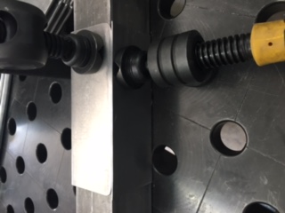

Several ways to attack the OCJs (outside corner joints). Since your Aluminum is thin, recommended you envelope one edge against the other. And yes, install blocking flush to the ICJs (inside corner joints) of your assembly prior to arclight.clavius wrote:.... I have seen videos of guys doing similar welds on outside corners with the parts clamped to an aluminum block. So I tried this on some scraps with pretty OK results. They were overlapped and fusion welded.....
Images below for work earlier this year show .040" 5953-H32 Aluminum. Fused with 1/16" 5356 filler. Recall running these at ~ 60A, 68-70 Balance, 110Hz, with 1/16in 2% Lanthanated Tungsten on a CK Worldwide Series-18 FlexHead torch. Notice the black flecks in the weld line. Surface contamination. Did not wipe down the filler prior to use.
The 2in x 2in x 12in 2024-T3 blocks provide the "internal backing" discussed above. You do not/not have to use Aluminum for the backing, but we prefer to use Aluminum/Copper for chill blocks. Especially for stainless steel.
Fitup for these welds is critical and needs to be tight. The root of the welds......no images, sorry.....were approximately three-quarters penetrated, IIRC. Going for CJP (completed joint penetration) for our application was not in the cards.
Also, recommend you use filler for these applications. We did however tacked, without filler, in four locations prior to weldout.
- image3.jpeg (21.17 KiB) Viewed 5279 times
- image1.jpeg (26.95 KiB) Viewed 5279 times
- image2.jpeg (25.9 KiB) Viewed 5279 times

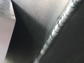

First, thanks very much for the very informative and detailed post. Very helpful, gave me a great starting point for settings and such.
I tried using pretty much exactly the settings you outline, the only difference being that I was using 4043 filler as that's what I have in 1/16" on hand. I was just doing a bunch of practice runs using scraps of the same metal I'll be making this from. They were clamped to a 1x1 aluminum bar as a backer and i was doing more of a "lay wire" rather than dipping as my coordination is still not great.
As you can see from my bit of modern art in the photos, not 100% awful, not all that great either, but somewhat heading in the vague direction of good enough. For what this will be, anyhow.
I need a lot more practice.
In any event, I need only in this case to get the pieces to stick. Pretty sure I can always flap-disk them into workable shape with some additional practice.
Thank you again for taking the time to reply. Most appreciated and helpful!

Aluminum filler doesn't "lay wire" very well. The ambient heat from the cup and welding tends to melt back the filler unless you are constantly jamming it back into the puddle. Better to focus on holding the rod at an angle to your puddle, dipping the filler into the puddle, withdraw it, then move the arc forward. Keep your amps low to allow you time to get the rhythm right.
