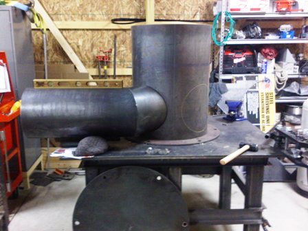

- A 55 ft. DIAMETER DIGESTER LID FOR CITY OF YOUNGSTOWN WASTE WATER TREATMENT
- IMG_0178.jpg (70.26 KiB) Viewed 3195 times
- 24 in. INLET DIFFUSER FOR VAN PORT WASTE WATER TREATMENT
- IMG00192-20110210-1537.jpg (42.96 KiB) Viewed 3195 times
- A LIVE 48 in. WATER MAIN SADDLE FOR THE MAHONING VALLEY SANITATION DISTRICT
- IMG00127-20100903-0806.jpg (53.11 KiB) Viewed 3195 times
