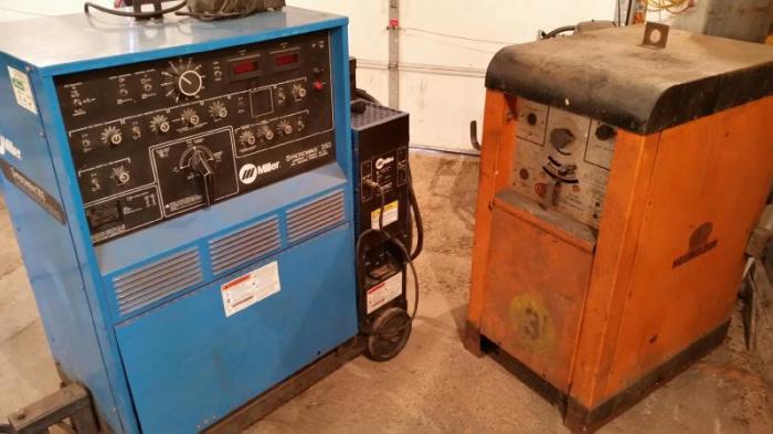

Dynasty 280 would be pretty cool, my machines are a little heavy...need both hands to pick them up
The syncrowave 350 has wheels, so it qualifies as "portable"
The only real plus for the old machines is price: $225 for the one on the right, $1800 for the blue one.
- syncro 350 airco 300.jpg (42.72 KiB) Viewed 3631 times
