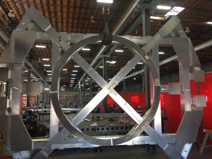

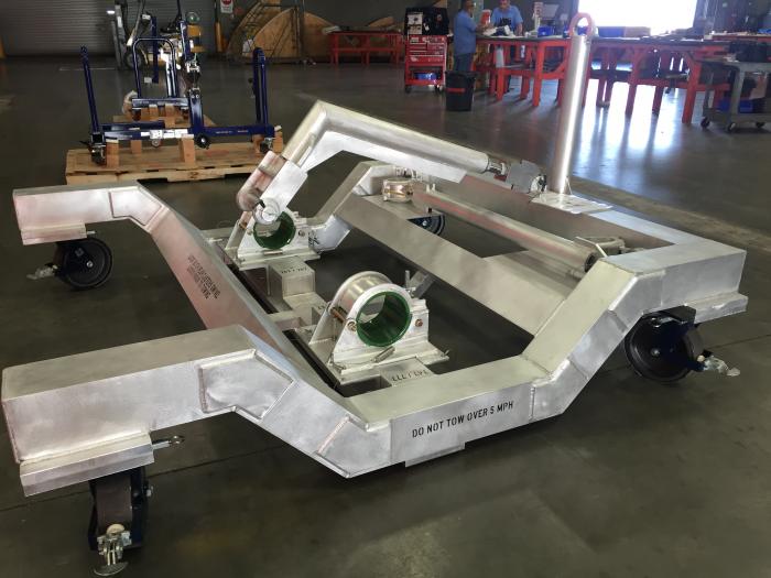

Hi guys I'm new to the forum but not new to welding. I have been welding for a couple aerospace companies in Southern California. Anyways yes you can weld aluminum in DCEN with 100 percent helium high purity grade not balloon grade. If you know how to weld it it comes out just as nice as ac or even nicer, especially if it is really thick aluminum like 3/8 or thicker.

Haha yeah here are a few jobs I did with DCEN, it's my first time posting pics. so hopefully they show up. And yes where I currently work we use DCEN.

Now THAT is aluminum welding! One question..what are those?
Pretty darn cool Gon-Welding951
Since the amperage is dramatically less with DCEN on aluminum, mind telling what amps (approximately) those were welded at for reference?

Thank you guys. Usually on 1/4- 3/8 around 205 amps anything thicker like 1/2- 2" 210- 250 amps. My favorite set up is a 3/32 red band tungsten #7 gas lens and 40- 60 cfh on helium.
