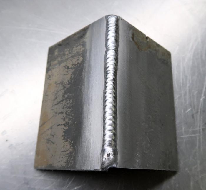

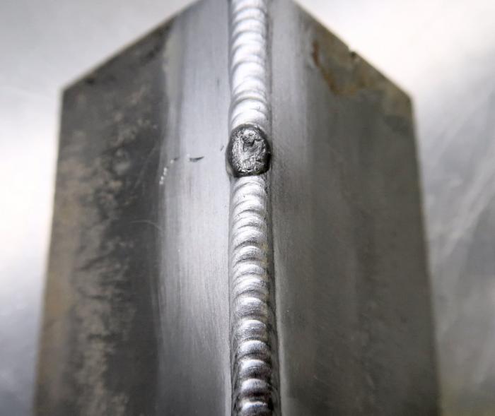

In a recent thread it was suggested to use silicon bronze to repair a pin hole in aluminum, so I thought I give a try to see what happens. I welded two 1/8" Al flats, drilled a hole and went for it.

Since the aluminum melts at a lower temp that should be expected-silicon bronze and aluminum mixing kind of like steel and aluminum it isn't gonna work to well. I feel bad you had to ruin such a nice bead.
That is some nasty aluminum you have there though.

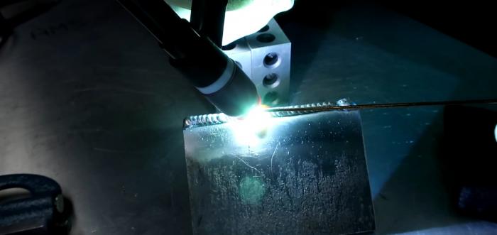

I tried yesterday too since I had it out. But tried on DC and it just wandered and rolled it upLtBadd wrote:In a recent thread it was suggested to use silicon bronze to repair a pin hole in aluminum, so I thought I give a try to see what happens. I welded two 1/8" Al flats, drilled a hole and went for it.

Hmm just looked really dull figured it was ac, I might try that and see if anything different happensLtBadd wrote:I did use Dc for the Silbrz weld5th Street Fab wrote:I tried yesterday too since I had it out. But tried on DC and it just wandered and rolled it up

As stated in the completely wrong initial post, someone else in another thread talked of using silbrz to fix a hole in AL, I just wanted to give it a try and see what happens, and here we are.MinnesotaDave wrote:I guess I'm puzzled by this thread?
