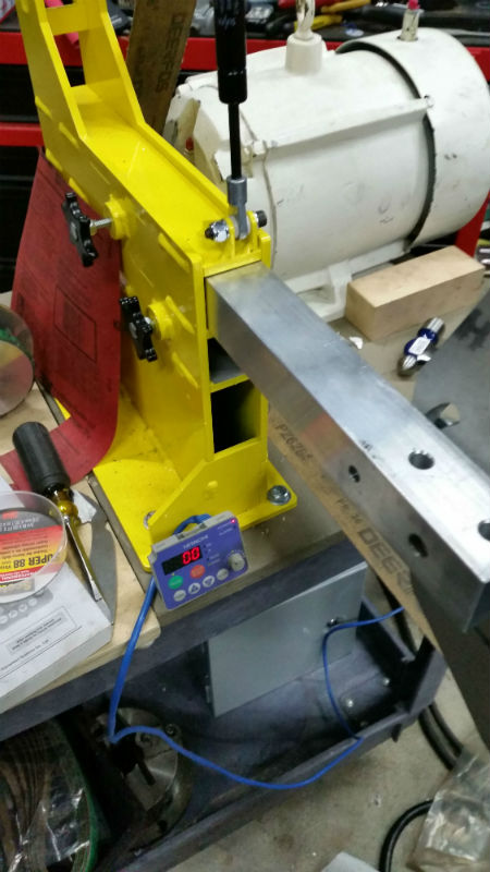

I got a "mid-dollar" one! It's called an Oregon Blade Maker. I had to make a platform for it, add my own motor, make a drive pulley, connect a VFD, wire up the VFD, and put a steel VFD enclosure together. Now that I have it, I realize I could have made the grinder body myself, but the guy who sells these is very reasonable, so it's hard to find motivation.electrode wrote: Did you get one of those high dollar ones that knife makers use? You say you put it together. Was it a kit? Pics?
- 11 04 16 VFD panel mounted on grinder platform small.jpg (70.08 KiB) Viewed 2508 times

I have an insane amount of money in it. The thing is, I had a VFD I wasn't using, so that made it feel like I wasn't spending much. A good VFD will run $300 or so. I also had a motor which turned out to be unsuitable because it wasn't enclosed. The grinder is $500. I put about $130 into the new motor, including shipping. I also bought the little grinding platform that hangs off the platen.
I used a 3 HP motor because I was having a hard time finding a 2 HP job on Ebay, and I saw that 3 HP motors were easy to find and cost about the same. It has more power than I really need. It weighs more than twice what a 2 HP motor does.
I think this is better than putting $1500 into a used Burr King that does practically nothing.
I suppose you could make the grinder body, tool arm, and platen for less than $500, but it wouldn't be dirt cheap, especially if you had to buy the wheels instead of making them.

A VFD is a variable frequency drive, which is an electronic marvel which will allow you to change the frequency of the AC going to a 3-phase motor. That changes the speed. You can take a 60-Hz 1800-RPM motor and run it at 900 RPM, 3600 RPM, or whatever the motor will take. It lets you pick any speed you want. You don't have to settle for a few predetermined speeds the way you would with pulleys.
It will also change 1-phase into 3-phase, so you can run 3-phase motors on your garage's 1-phase 220 power.
For a grinder, it's good to buy a VFD that comes with its own dustproof enclosure. A lot of people like the ones made by KB Electronics. I did not have that kind of VFD, so I had to buy a steel box and mount my VFD in it.
