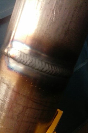

Im fairly new to welding in general but my question is how long do you normally wait between passes on 3" and under stainless schd 40-80 i can never seem to end up with a nice cap its laying horizontal when i do my cap so traveling vertical
I wait till you can almost touch it, depends what the WPS says for max inter tempsAndrewchisholm wrote:Im fairly new to welding in general but my question is how long do you normally wait between passes on 3" and under stainless schd 40-80 i can never seem to end up with a nice cap its laying horizontal when i do my cap so traveling vertical
I've been doing a lot of 3-4 inch schedule 10 lately and I usually just turn my heat down as far as I can on my cap after waiting 20 minutes or so. I usually prep another piece in the interim and then know the cap out at about 70 amps.
What position are we talking about?

Here's some 3 inch schedule 10 stainless in the 6G position to demonstrate:

@Ryan_82 Nice work Ryan
