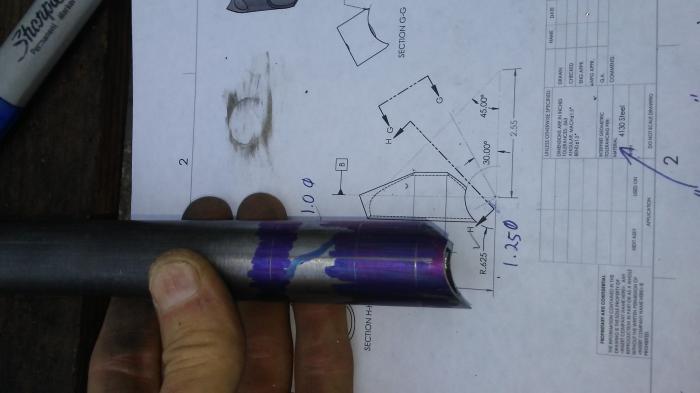

My son is in his final semester of mech engineering and has his capstone project of the ASME design-build of a human powered vehicle..basically a bicycle frame. I volunteered to do the welding so I better get good.
I fishmouthed some 1/2" EMT, then pickled the zinc off with muratic acid. Jigged it tight, 4 tacks and went to work.
It is 0.702" OD with 0.042" wall. Smaller and thinner than the project which has yet to be finalized. EMT is low carbon, the project will be 4130.
Any tips? 50 amps, Rule of 33 on pulser, 0.035" S2 filler and 12 cfh argon through #7.
It looks kinda cooked but that could be from using acid on it. Welds look good.
Yes, practice makes perfect. Thankfully the EMT is dirt cheap as I have a bucket full of drops. But 70 amps on 0.042" carbon steel? I'm rubbing 1/16" thoriated tungsten so that is fine. I might try larger coupons and let it cool a bit. Tacks are colorless as were the first 1/4s..welded thinnest parts first, saving inside corners for last. Joints were tight, zero gap since the steel cuts like butter. Not the same on chrome moly..will get carbide burrs for that. Using a die grinder in a home made jig with rotary files. Then hand file burrs and just breaking edges.

Another issue is set on vs set in joints. Since I am writing the WPS for these joints, set in or portholed joints might be required. It is common in bicycle frame construction on high end cycles. Saves a tad weight but really makes the weld tricky.
Looks good from here! 75-80A on 0.042" wall!?! Yikes, that's above my pay grade, that's for sure! Try it at your own risk. I suspect one would have to have their technique down really good to pull that off.
If you want to control heat tint/discoloration, try wrapping the T with flat copper braid, somewhat close to the weld joints, but not too close. If it worked for me and titanium, it will work for you.

Welding SOON. Right now it is metal massage with a tube bender. One bend is 3" centerline radius on 0.058" wall 3/4" OD tube. Too tight unless inside support so tubes are bent after filling with Woods metal, an alloy of bismuth, lead, tin and cadmium that melts at 158 °F. It bends like tin, minus the cry. Yes, taking precaution against lead and cadmium by melting under water with a drop of vinegar to keep pH below 7. No fumes and no oxides. Just have to dispose of that water carefully. Only a few ounces.
The tubes also needed normalizing to bend so I made a tube furnace with 6" stainless chimney liner, ceramic wool and a few plate scraps. Heated the ID with a torch and monitored the exhaust temp with a thermocouple. Then plugged both ends and let it cool for two hours. Tubes had slight warpage which was easy to remove with the tube roll machine.

Coped tube welding is one heck of a complex weld.
The change in angle is so marked as you weld.
I'm no expert by any stretch but one thing that helped me was to think about the joint in distinct parts.
The right angle side is a fillet weld. The flat side is a lap weld. Subtle differences in where you direct the heat and how much filler you add.

Great tip! Only a few joints not at right angles. Gas lens plus huge stick out. I'm planning every weld since first view of the drawings.
The welding will be the easiest part. Bending tubes is the worst.

Here is a crude drawing of frame subassy. Also welded would be steering knuckle- kingpins and minor attachment points.
Here is the roll hoop. I made plywood templates for bends to preserve sanity. They worked great in bending.

Ever have an "oh CRAP" moment? Yep, scratched cornea. All better now. Bends and copes done, just down to fitting, tacking and welding. Great news is new hole saws at correct speed do a wonderful job at cope miters in the drill press with Harbor Freight tube notcher. 1600 RPM on a 1" Milwaukee bimetallic is golden. Blue chips are the goal so watch feed. No cleanup other than debur.
Have to say Blue Ox Lenox hole saws seem to cut better but are more fragile. But WTH do I know as this is my first CrMo rodeo. I do know when feed and speed are right, it cuts great and fast.
When chips turn blue, all is good. Put heat in swarf and the tool will stay cool.
