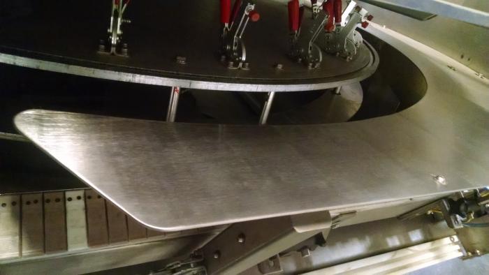

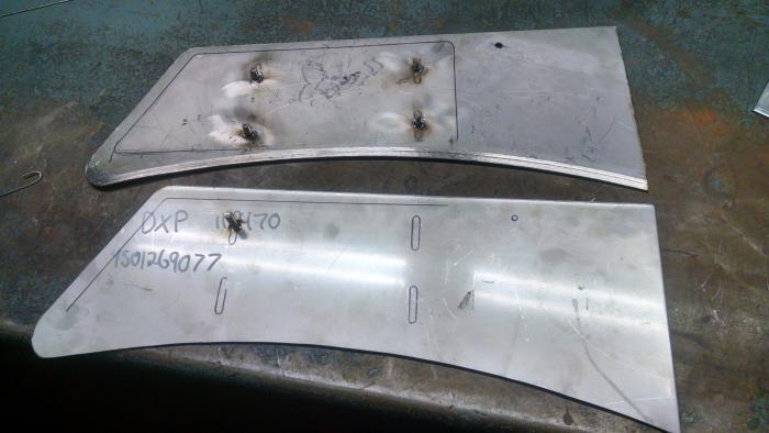

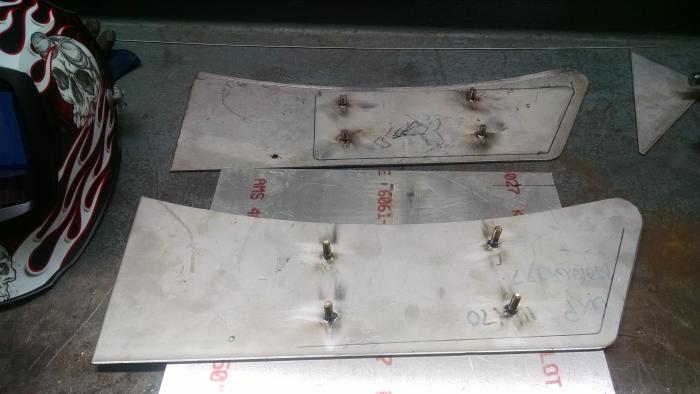

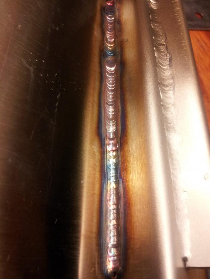

Repairing a section of damage on a bottle machine...cut out bad section, fab new one with studs and then weld it all back in. 1/8" 316L Stainless
- IMG_20150824_203756460.jpg (33.45 KiB) Viewed 2118 times
- IMG_20150824_203748618_HDR.jpg (34.42 KiB) Viewed 2118 times
- IMG_20150824_214724029.jpg (33.88 KiB) Viewed 2118 times

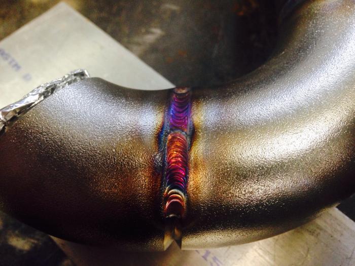

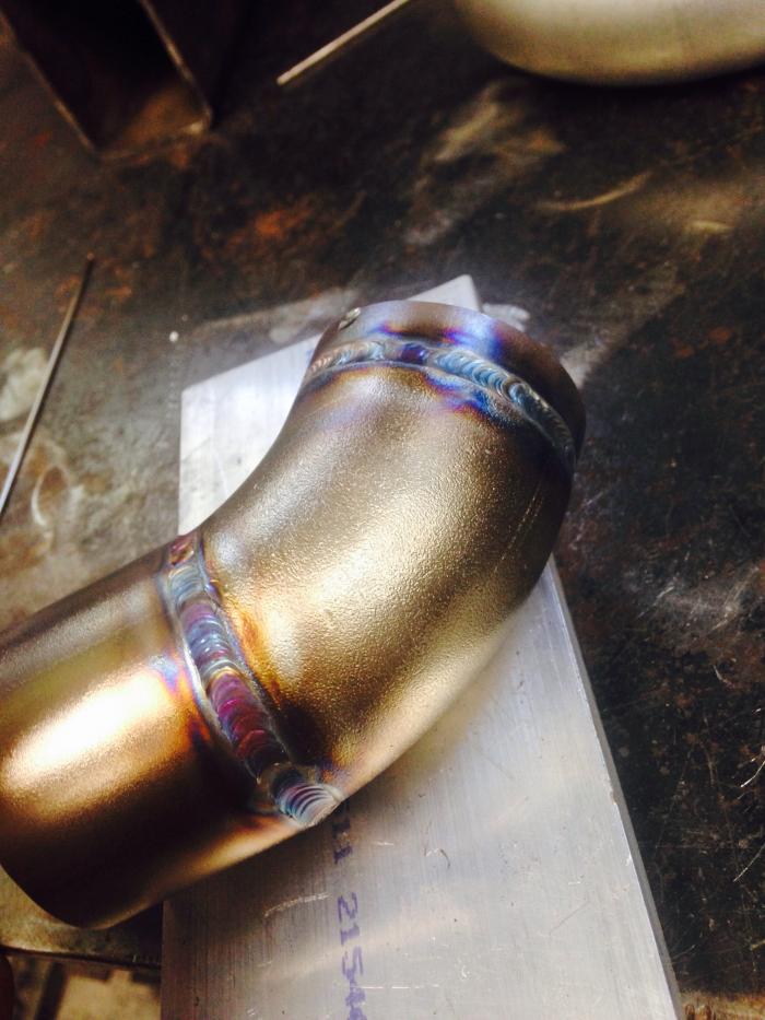

Getting some welds done
- image.jpg (79.06 KiB) Viewed 2114 times
- image.jpg (64.8 KiB) Viewed 2114 times

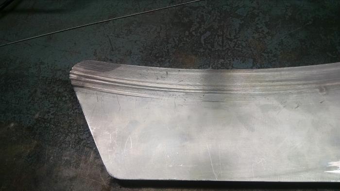

Did final clean up today...I love my Metabo burnishing tool
- IMG_20150825_152008867.jpg (36.28 KiB) Viewed 2074 times
- IMG_20150825_152014759.jpg (23.6 KiB) Viewed 2074 times
- IMG_20150825_200028780.jpg (32.66 KiB) Viewed 2074 times
- IMG_20150825_200037083.jpg (27.03 KiB) Viewed 2074 times

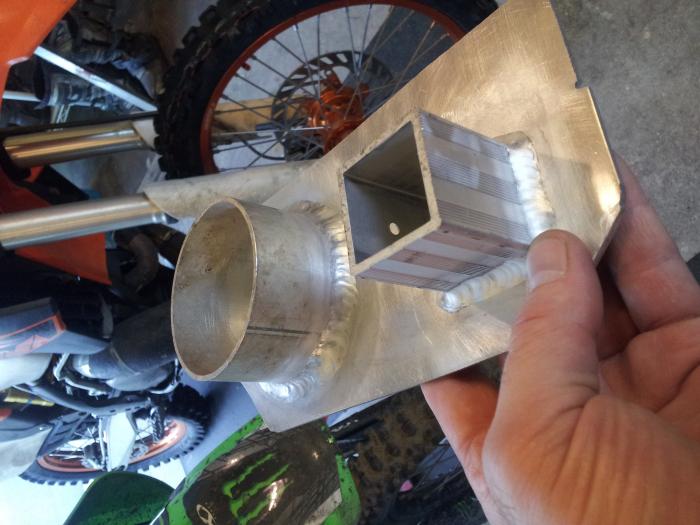

My boss liked my aluminum pen holder so I decided to make him his own .
Made this last night, wasn't purged, just a chill block underneath.
- PenCup.jpg (80.99 KiB) Viewed 2098 times
- Cup2.jpg (75.48 KiB) Viewed 2098 times
