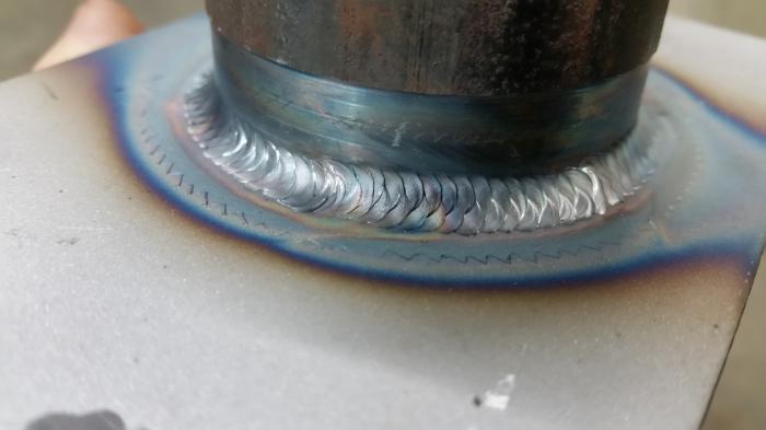

I've been busy the last 2 weeks and hadn't got a chance to try this again until yesterday. This was my 4th try. Looks a little better than the 3 that I did 2 weeks ago. What do I need to work on?

big gear head wrote:I've been busy the last 2 weeks and hadn't got a chance to try this again until yesterday. This was my 4th try. Looks a little better than the 3 that I did 2 weeks ago. What do I need to work on?
I'd say looks pretty damn good. If I had any crtisim I'd say it looks a tad underfilled on the left, could be the pic.
Your walk looks good, consistent...
I would say you have the torch part down. What that looks like to me is more about your positioning and trying to go too far before changing position. Whenever you start to get comfortable passes, remember that perspective between your body and the torch, field of view etc. I still catch myself slacking off at this sometimes.

I repositioned 6 times and tried to keep my angle the same as I moved around. I'll try repositioning a little more often. This lay wire is all new to me and I don't know if I should be forcing more wire into it or not. I'm using 3/32 wire and a #7 cup with a gas lens. I'm not forcing wire into it, just laying it down and going over it. Do I need to reduce the amount of movement with the torch so that the bead is not as wide and maybe a little thicker?

You're actually doing really good. Only people who are going to show better examples are those who weld the same types of joints every day and have the type of materials and fittings around that afford them that much practice. Try scribing some soap stone lines as guides if you need just one to come out neater if these types of jobs are few and far between.
    Wed Aug 06, 2014 12:48 am
    Melbourne, Australia
Frankly I though the effort was pretty sensational, there certainly wasn't too much wrong with that. The technique looked really well controlled. Great job!

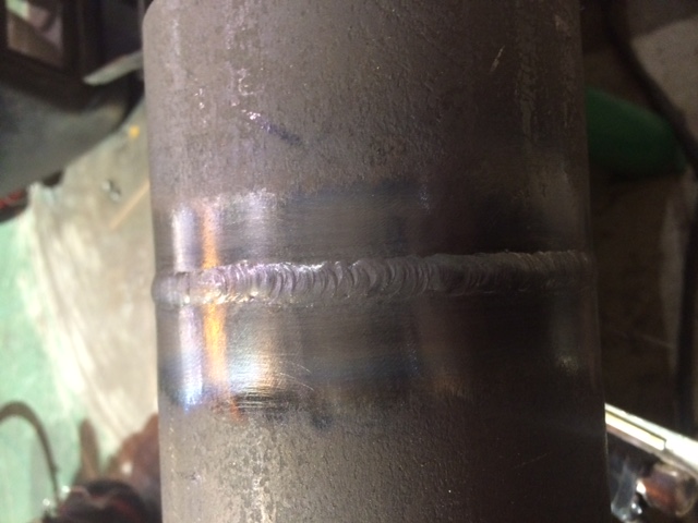

I'm learning to TIG weld pipes after hours at work. Had big problems doing the root pass on 6G, so instead I try to learn vertical up, walking the cup, before i even try the 6G again. Learn to walk before running eh?
Learned everything from Jody and this forum! I hope to become a sertified welder someday!
Root pass, 2mm gap
Root pass, 2mm gap
Root pass inside
Root pass inside
Cover pass
Cover pass

Nice looking welds on the boat. Those can be hard to weld sometimes and your beads look very good.
Pipe welds look very good for a beginner. I've never been good at that. I've got friends that are boiler makers and I'm amazed at the work that they do in the conditions that they work in.
