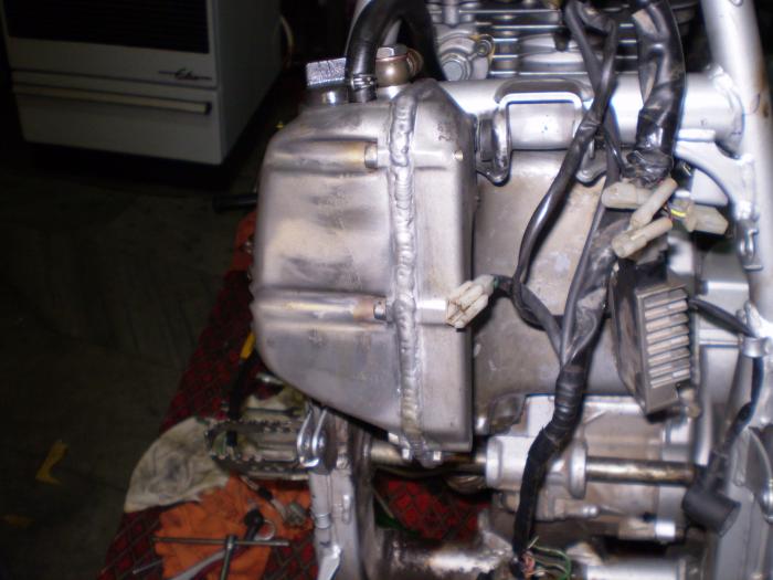

ESENTI
    Wed Jan 04, 2012 8:36 am
Dear Mike, you do well congrats , Can you say few things more about EN and EP please .I always try and I always fail to produce nerrow clean seams or beats . What is your gas flow ? .
Esenti

Dear Mike, I have fronius magic wave 2200 2 years now .Its a good machine. ( i was close to buy a miller but since in Greece
it is not easy to find i choose Fronius) .
My welding has not impressed anybody yet. Only lately i have started to take some score out of it . I usually do repairs where you need a very powerfull machine to manage an aged aluminum corroded and fatigued . I like good penetration to boil all in -purities out and then appearance.Usually the pieces i weld are so dirty that is very hard to clean properly.
These are older welding i do better now . I do better in appearance when i make stops
with the tig torch switch . You do impressively better well done .
Esenti ( from esential )

Looks great! Doing repairs on oil soaked cast aluminum is a lot harder than what I'm doing.

Thank you , I think there is some room with my adjustments i enclose the POS and NEG off my machine , i use square wave
POS and NEG waveform Is it ok? . The ark seems a bit not focus and lacks of accuracy .
Esenti

Use ear plugs and square wave, start at 60% EN or 40% EP. Sometimes arc wander is caused by too large a tungsten. Your grind should be blunt.
