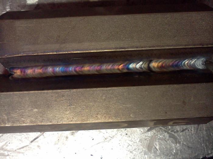

I know you weren't saying my technique sucked, I was. :D Thanks for the tips and encouragement.

The weave is underneath. :D

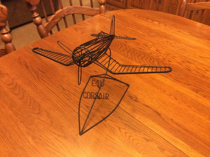

Here is one of my airplanes made from welding wire.
F4U Corsair
F4U Corsair
Mike the wire airplane guy http://www.wiresculptor.net

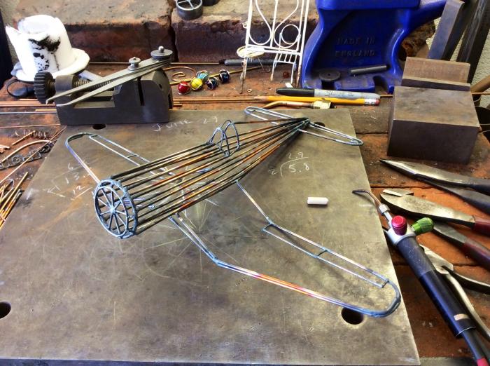

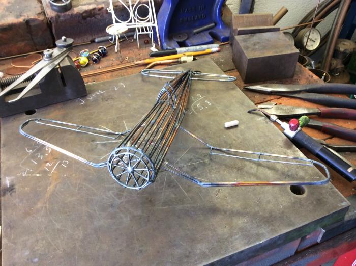

Here are some progress photos of my wire model desktop sculptures...
I love aviation...

Mikechallgren,
That is very neat stuff. Time consuming, precise and an excellent finished product. Hats off.
Run down a bit about how you do it, if you would. Forming the wire, size of the O/A tip, anything you want to share.
WW2 aircraft is a big interest of mine, got me through 3 years of history without having to write about anything that bored me.
Post up more of your work, I'd love to see an F6 Hellcat or a Dauntless. The Shiden Kai was an interesting plane too, but that's obviously on the other team :evil:

newschoppafowah wrote:Mikechallgren,
Ditto. More info, please! I'm very interested to hear how you form the parts, and your technique for welding them.
I've done two wireframe projects, and had good success with fusion welds down to 1/16" with ER70S2 rod, but 0.045" had a high failure rate (it's got a very narrow range between plastic and liquid, and getting a joint without it balling up is tough). I had better luck at that gauge with a springy piano wire alloy; however, it became very brittle after welding. When I got into TIG, I never expected to be pulse welding at 6-7 amps to control the heat!
