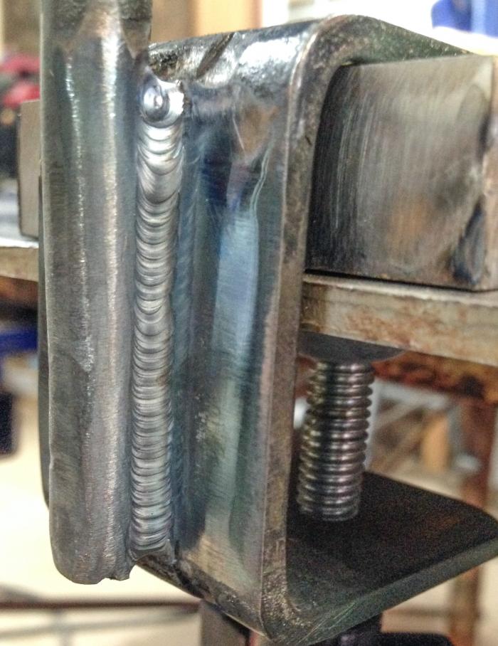

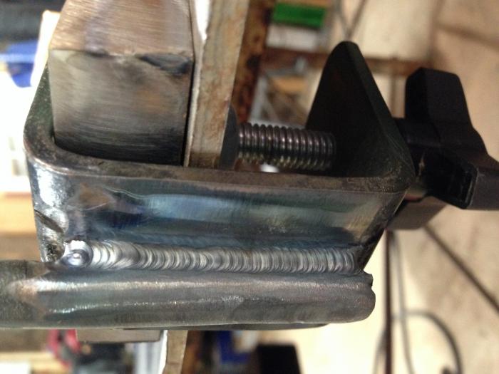

Hey thanks man, I appreciate the encouragement Otto. Sometimes you gotta get a little creative and fenagle something with what you have. Now that is the best looking of the welds, sometimes it took a little while to get the two pieces to melt together before I added metal. Do yall think maybe I should have went with a little more heat? 5 amps or so? Any criticism is welcome
Thanks folks!!
Nope... The color, and the size of the heat-affected zone seems spot-on for the repair you were doing. My only critique would be to feed a bit more rod with each dab, so the weld is not concave. Your goal should be for it to be at least flat, but preferably a bit convex, so the joint between the parts is "rounded over".FitNPipe wrote:Hey thanks man, I appreciate the encouragement Otto. Sometimes you gotta get a little creative and fenagle something with what you have. Now that is the best looking of the welds, sometimes it took a little while to get the two pieces to melt together before I added metal. Do yall think maybe I should have went with a little more heat? 5 amps or so? Any criticism is welcome
Thanks folks!!

And this is where I wish there was a "like" button!Otto Nobedder wrote:FitNPipe,
This is one of those moments I wish this forum had a "like" button like facebook...
Li'l redneck engineering, li'l new welding skill, li'l new machine, and problem solved... Keep practicing, keep following Jody's videos, and keep up with us, and you'll be teaching your welder in no time...![]()
You are one of the guys I as a new member of this forum noticed as highly professional and displaying also things where you are not satisfied with your work.
And then encouraging us at the hobby level like that. I wish all forums on internet was that friendly.
Thumbs up to you as well as to to FitNPipe. If that smoker falls apart, it will not happen at those welds.

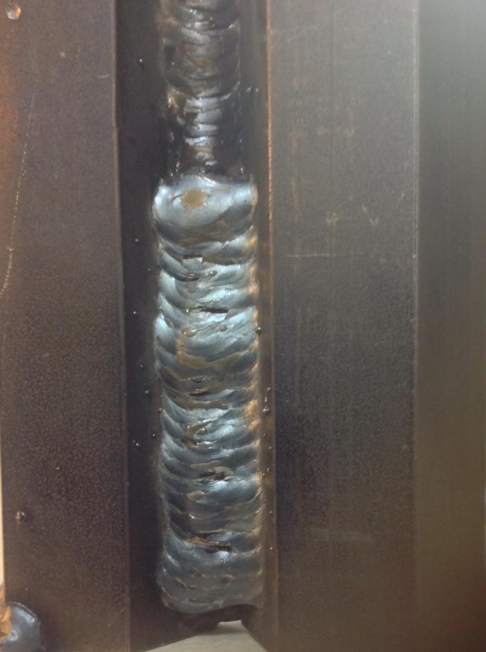

I didn't do any real jobs today so I did a little practice with GTAW(TIG) on some plain mold steel in a T joint.
- image.jpg (18.04 KiB) Viewed 2430 times
- image.jpg (43.95 KiB) Viewed 2430 times

Justin,
Looking good there! I would wire wheel between each pass. Keep up the good work!

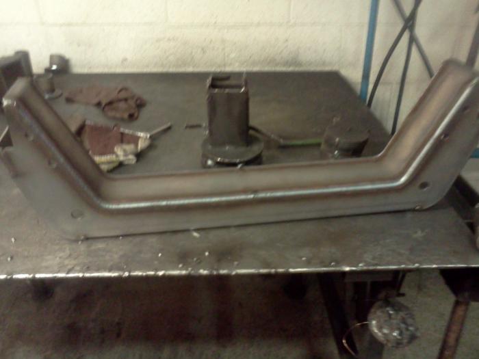

I welded these gate frames a few days ago I thought I'd post them any way. I also built the fence. I'm a fence contractor and I welding and fabrication.
- image.jpg (44.22 KiB) Viewed 2278 times
- image.jpg (88.76 KiB) Viewed 2278 times
- This a flower pot holder that attaches to the railing of a deck. I had 6 that I had to cut off the bracket and turn it around 180 degrees. Tig them

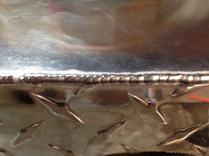

I got a customer that hired me to fab up boxes so he can install a stereo system on his arctic cat side by side. I'm .063 aluminum plate and .063 aluminum tread plate. I'm using a AHP ALPHA TIG 200 ex 3/32 tungsten and a #7 cup. I had the welder set to 85 amps using a foot petal. it's ok Its a decent starter welder. I'm going to upgrade to miller dynasty 200dx or a Everlast does anybody have a Everlast AC/dc and do you like it? My ahp has pulse but only .05-10hz and AC balance is only + or - 5%. I need a better tig welder I've out grown my AHP.
- image.jpg (41.82 KiB) Viewed 2255 times
- image.jpg (48.06 KiB) Viewed 2255 times

Bholcomb87,
I was going to comment on the gate frames (nice), as I had some brief experience, but I think your diamond-plate speaker boxes are sweet. With weatherproof speakers, you could sell the hell out of those! Nice work.

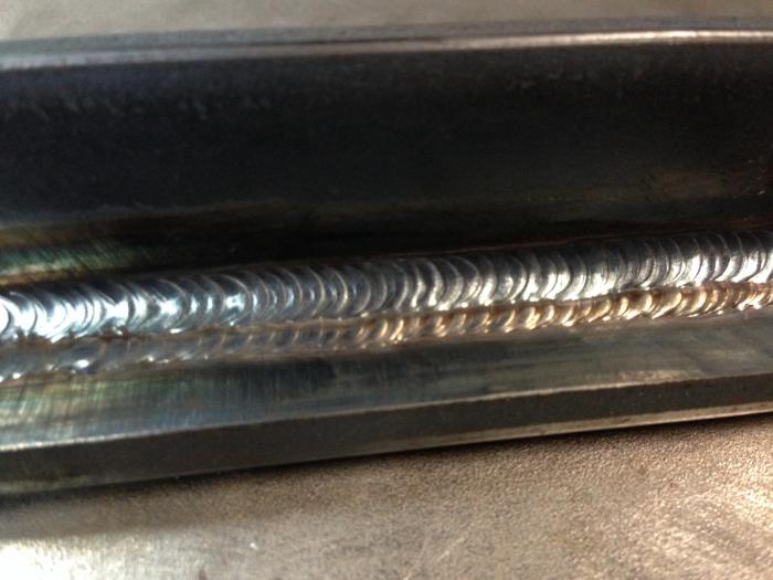

Total newb here, and this is probably my third day of practicing laying down beads. I probably have 3 hours of total torch time and I feel like I'm kinda starting to get a handle on it. It took me quite a bit of time to get the settings right so I wasn't grinding my Tungsten every bead. I quickly learned that too much AC cleaning is not a good thing.
Anyway... here is the best I've gotten so far. I will continue to practice, practice, practice. I'm having lots of fun.
I've already learned lots from this forum and am very happy I stumbled across this place. Tons of knowledgable people who are willing to share their expertise...
