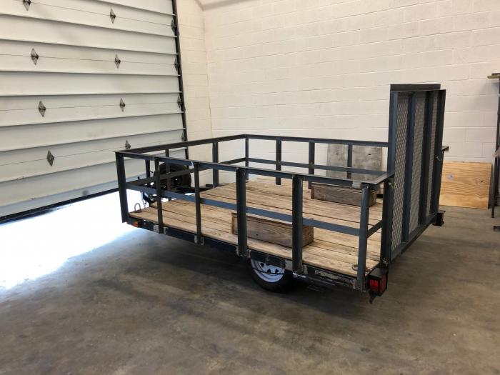

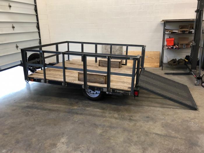

Trailer retrofit to add walls and a removable ramp/gate. Built to customer spec. Mostly 11ga 2" angle and flat bar, and some 9ga expanded metal for the ramp. Definitely great practice to get back in the MIG groove since there was pretty much every joint combination and in every direction. The ramp hardware fittings and expanded metal was TIG welded.

golly, Spartan, you certainly get into some kind of "stuff". Did the customer bring the trailer to you with the boards and the apple crates already on? And the shiney parts where the ramp meets the trailer - are they hinges for attaching the ramp?
It was brought in exactly as it was in the first pic. I did nothing with the wood, other than maybe make it smoke a bit at timesBillE.Dee wrote:golly, Spartan, you certainly get into some kind of "stuff". Did the customer bring the trailer to you with the boards and the apple crates already on? And the shiney parts where the ramp meets the trailer - are they hinges for attaching the ramp?
I think the shiny parts on the ramp you're speaking of are just the little stitch welds used to secure the expanded metal to the ramp framing. I used chunky clevis pins and some turned/drilled round stock bearings to act as hinges for the gate, but they're not quite visible in the pics. Used the clevis pin/bearing method so that ramp would be completely removable with relative ease.

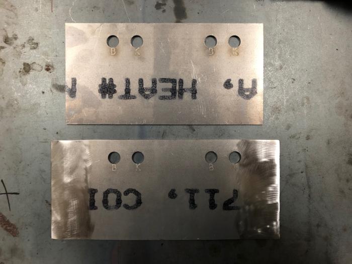

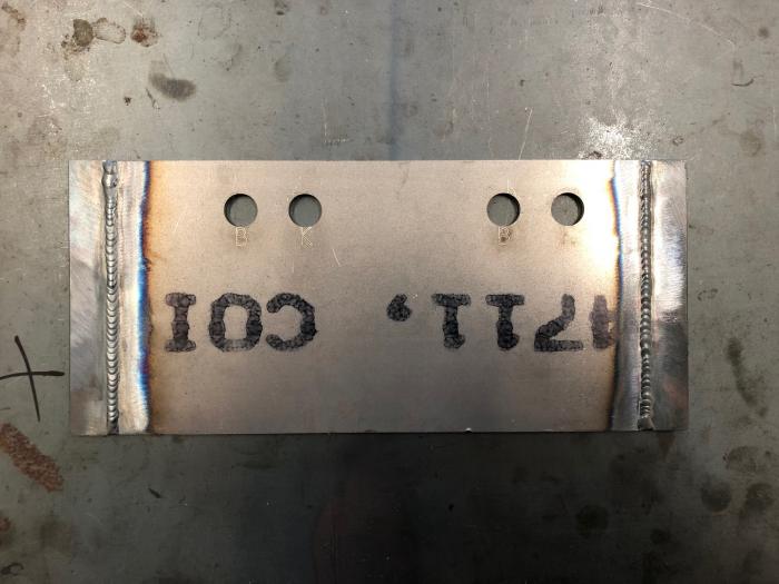

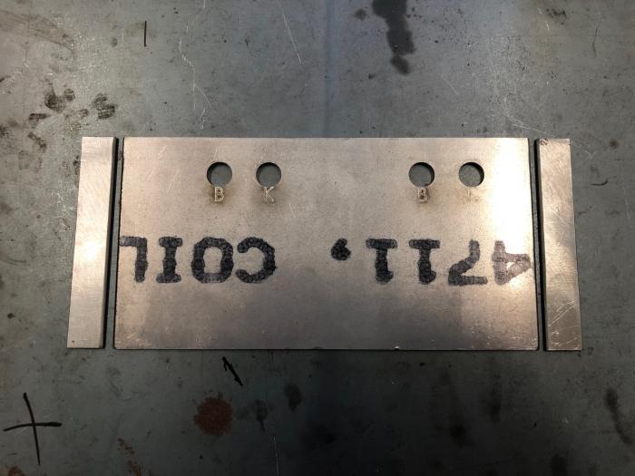

Quicky Mod. Customer had five laser cut parts that were designed too short and had to be put on assemblies and shipped YESTERDAY, apparently. 4130 chromoly plate, 11ga, needed an extra 0.750" on each side. Luckily he had some extra plates he was willing to part with so TIG was the best option for a fast turnaround....just can't find that stuff at Lowe's
Cut double bevels and ran some heavy, built-up beads on both sides of the plate before grinding. 70S-2 filler, and the nugget was fairly visible after the scotchbrite. Gets a powder coat, so finish wasn't too critical but I tried to treat it nice. Was a bit worried about warpage, but wasn't an issue at all with some reasonable chill bars. For those new to welding 4130, chill bars are typically not recommended, but it was permissible for this largely cosmetic application.
My favorite kind of work, and the reason I love me some TIG

Made money and scored points with the customer, win - winSpartan wrote:just can't find that stuff at Lowe's

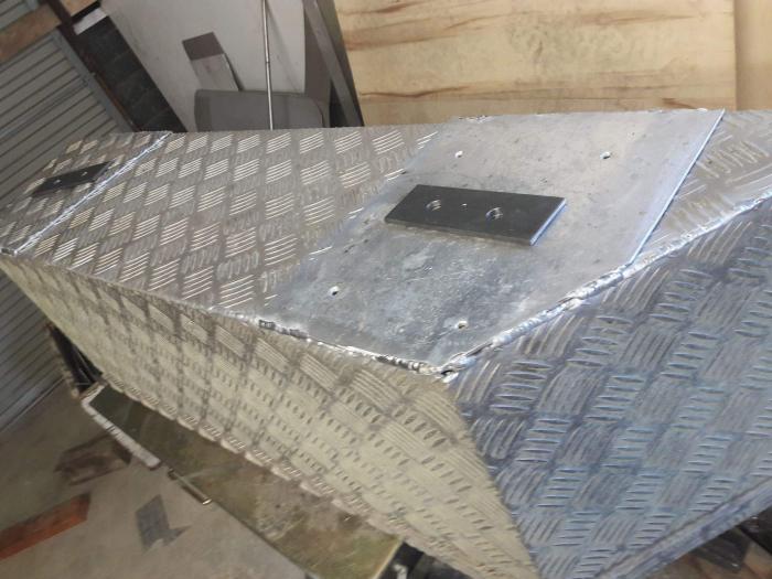

yes, same old cheap who knows what grade it is.BillE.Dee wrote:Nice job Tweake. I"m supposing that material is what we in the states call diamond plate??
just with added fun by being dirty soaked in goodness knows what crap. spend more time grinding and cleaning than welding.
had it blow up a few times. not what i would call good welding but its back together.
got it back on the trailer and found why it broke, the brackets holding it where to short so all the load got placed in the centre of the panel rather than out on the edges. just have to extend those brackets a bit and its back in service.

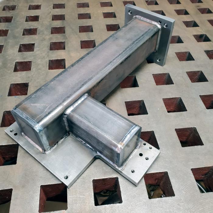

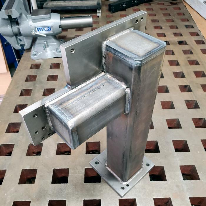

Very nice looking work Richard.
Love that acorn table also...you keep it clean!

Nice work ,, Richard. That going around corners is sometimes a challenge especially in the tight spots. All , and I mean ALL of the work shown is great. John Q public doesn't realize what is involved in the industry...from the first time someone touches stinger, gun or torch to the where they are today. KEEP ON KEEPING ON !!

Spartan wrote: Very nice looking welds!
TraditionalToolworks wrote:Very nice looking work Richard.
VA-Sawyer wrote:Don't ask the story behind that table, it will make you cry. It about made me cry. It did make me green. Yes, it is a really nice table.
Thanks for the comments, the table was given to me by a customer, I just had to get it movedBillE.Dee wrote:Nice work ,, Richard. That going around corners is sometimes a challenge especially in the tight spots. All , and I mean ALL of the work shown is great. John Q public doesn't realize what is involved in the industry...from the first time someone touches stinger, gun or torch to the where they are today. KEEP ON KEEPING ON !!
