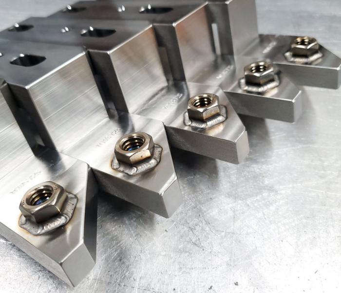

A recent stainless job

LtBadd wrote:A recent stainless job
:mrgreen:
very nice !
:mrgreen:
very nice !
Indeed, very nice work indeed Richard! 8-)

Thanks, these were done in my garage shop

LtBadd wrote:Thanks, these were done in my garage shop
Nice work! What amperage did you need?
I had my machine set on 150 amps with 300pps, 60% peak and 15% background, so not really sure what the weld amps would be, didn't need full pedal, used .045 filler with #8 cup and gas lens
very nice ,, Richard. Are they some type of door latch/striker ??
BillE.Dee wrote: very nice ,, Richard. Are they some type of door latch/striker ??
Thanks Bill
No, all I know is it's called a Connecting Elevator Bracket
