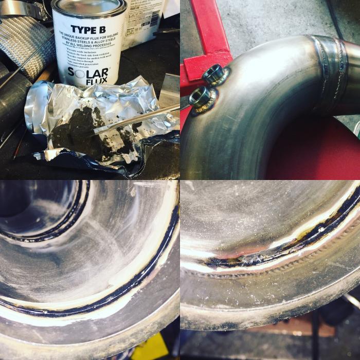

Keep forgetting to post my experiences with SolarFlux. This stuff is gold if backpurging stainless isn't reasonable or practical. I use it with ISO alcohol, works GREAT!!!
Did you butter up the two halves before or after you tacked them up?

Poland308 wrote:Did you butter up the two halves before or after you tacked them up?
After, I tried to keep the tacks shallow. I didn't clean it all up since it's just an exhaust pipe but I wiped off an area with acetone and it's nice and shiny metal underneath.
Cool! I was wondering if it would interfere with the weld process if it was worked down into a crack. I'm envisioning that you might be able to coat the two sides before you tack up. If there was no way to get at the joint after fit up.

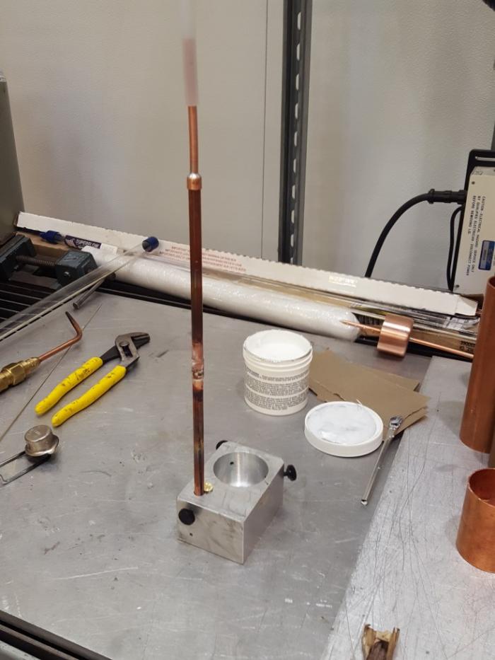

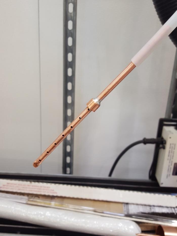

Practicing for a brazing cert, copper to copper using Harris Stay-Silv white flux and Safety-Silv 45 brazing alloy
Have to do 3/8" and 2" tubing
for nitrogen purge
for nitrogen purge
3/8 tubing
3/8 tubing

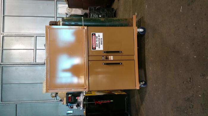

I got my welding cart done. I work for a bus company and need the security this setup gives me.

Closed

Could a moderator please rotate my pictures?
