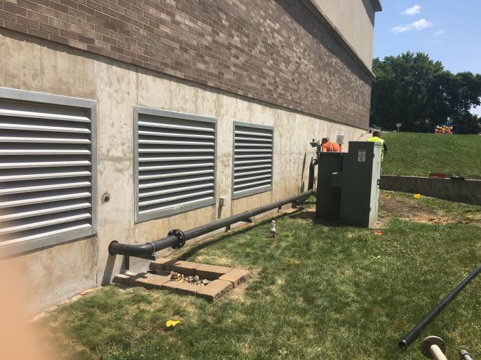

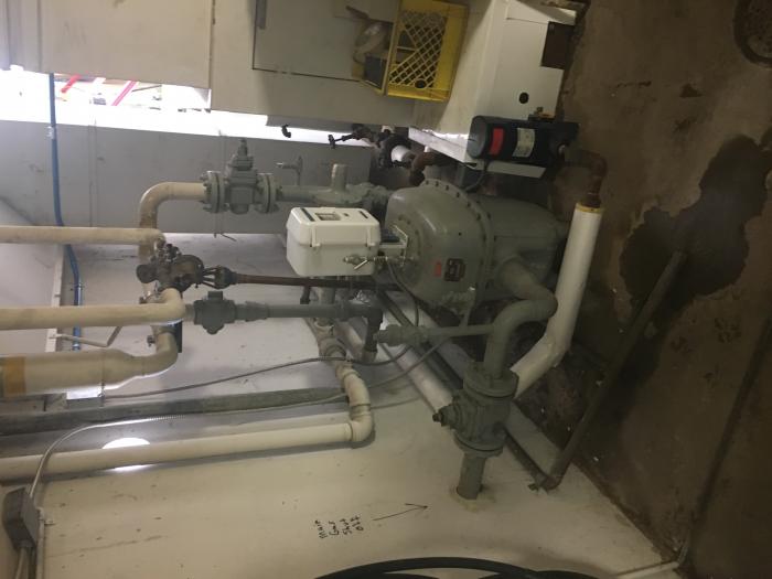

New gas service at one of the local schools. Gas provider set the new meter and I ran new pipe into the building. Only had a 4 hour window for actual shut down.

4hrs that's crazy man. You wouldn't have had time to scratch !
Sent using Tapatalk
Fortunately I was able to do most of the work ahead of time. the only thing left on shutdown day what's to bolt up the last 4 inch flange and do the two welds on the tee.

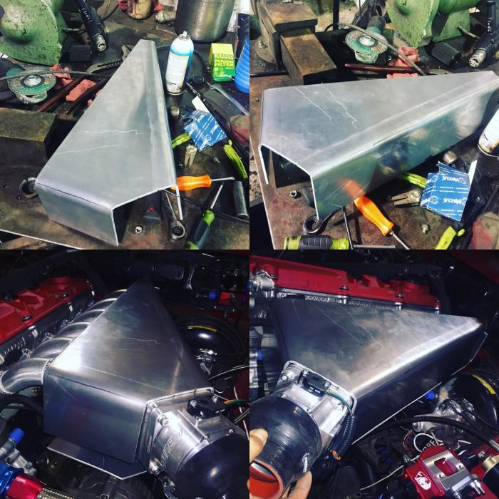

This was terrifying but so exciting! I posted earlier the beginnings of this, now it's all done, just need to add some sensors and pressure references, maybe a brace to the block. Last week I finally got off my ass and bought the plenum metal, and went to my friend's shop with a big press with my angle and rod to bend it. It worked well with the experiment with the coolant tank so I was cautiously optimistic. But even with 3003, it is just too much length with a single pressure point. The 1.5" solid aluminum bar bent before making much of an impression on the sheet (3/16" thick). I called several audibles, one was a steel jack handle, that crushed. Finally we found a 1.5" solid STEEL bar, I cut it to length and that finally worked. It almost seemed like it wasn't going to, it was bending a lot but wasn't yielding and when it bottomed out in the angle, it straightened out the bend. PSI is a bitch, I'm from an RC airplane model background and I should have an appreciation for load distribution but it's still hard to picture intuitively.
Alls' well that ends well, I'm SUPER stoked with the end result, I was cautiously optimistic that my skill level was now where it needs to be but I always tend to attempt things when they're at least a notch outside of my comfort zone and sometimes ability but that's what makes it fun...

That looks fancy and like you did a heck a job welding that all out.
Instagram: @farmwelding
Nick
D that looks nice and clean!
BigD
    Thu Jan 07, 2016 1:56 pm
Thanks a lot guys!
