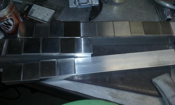

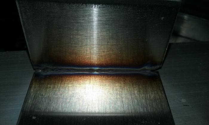

Here's some 16g I just did a sample for ya....
- Fitup and speed tacked @ 50amps
- IMG_20160618_175717.jpg (28.42 KiB) Viewed 1970 times
- IMG_20160618_180113402.jpg (42.81 KiB) Viewed 1970 times
- IMG_20160618_180122296.jpg (27.01 KiB) Viewed 1970 times
- IMG_20160618_180138171.jpg (26.09 KiB) Viewed 1970 times
- Backside....the 65amp got through but the material was hot by then too
- IMG_20160618_180202882.jpg (34.25 KiB) Viewed 1970 times
50 was actually fine, I was trying to show the difference a few amps makes (hard to see in the pics), I increased to 65amps since I upped the pulses to 10....
That setting usually works but with all the heat in only a 5" piece it actually caused it to go through and sugar with out a purge or backer.

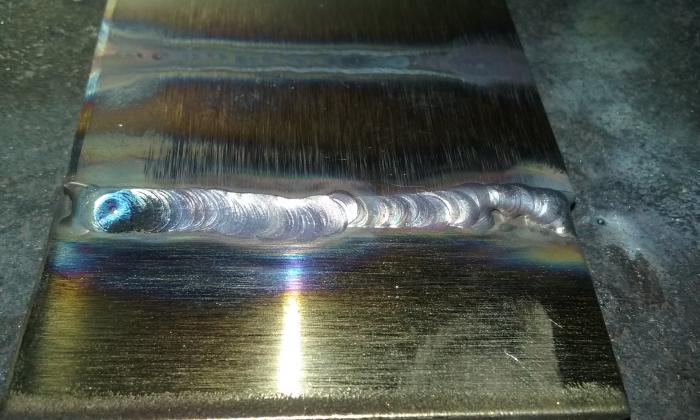

First attemp today. I looked at your pulse settings and dialed it back to 35 amps so that I can learn to control the puddle instead of relying on the machine per your recommendations. First tack at 50 amps went exceptionally well (right side), but it opened up the gap like a prostitute's legs on the left side. I had to squeeze the gap closed with my left hand and try to hold that while I tacked the left end. I wasn't focusing well enough and got the torch pointed at a bad angle, thus peeling back the top edge (50 amps). You can see the evidence via that big doo-doo ball on the left end. Had to tack right of that one and got it on the second try. Turned down to 35 amps and got the center tack. Lost sight of the puddle at the beginning of the first run from right to left, hence he lack of fusion. Should have waited a few minutes for the whole thing to cool off before proceeding from center to left but only waited about thirty seconds. That caused me to penetrate through the back side toward the end of the second run. Man, this stuff really is super sensative to heat and does not shed it very well. This never would have happened on mild steel. I think that I should have been rolling the torch counter clockwise as I moved right to left so as to roll the 16 gauge down into the gap but I was rolling clockwise instead. The 16 gauge is on the back side of the photo while the 18 gauge is in the foreground. It's sitting in the photo exactly as I welded it without a backer bar. I used 2" X .125 aluminum tubing and a pony clamp for the fit up.
- 20160619_113805.jpg (40.48 KiB) Viewed 1975 times
- 20160619_114134.jpg (41.78 KiB) Viewed 1975 times
- 20160619_114229.jpg (33.78 KiB) Viewed 1975 times
Raymond
Everlast PowerTIG 255EXT

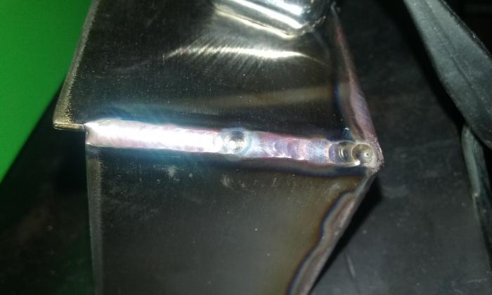

Lap joints. 40 amps on the first try. I don't think that I had a very good torch angle and it just wanted to roll over without tying in. I went back over most of the joint with a second pass but you can see what it looked like on the first pass by looking at the right side. I started out worried that I was going to peel the 18 gauge back but wound up with the opposite effect.
Flipped it over and cranked it up to 45 amps and caught a more favorable torch angle. This went twice as fast and worked out great even though I was now washing 16 gauge top plate into 18 gauge bottom plate versus the opposite situation on the first weld.
Interesting how five amps made so much difference and you can see the difference in the heat affected zones as viewed form the flipped over side from where it was welded. I was worried about putting too much heat into the parts like Exnailpounder had described and wound up doing exactly that by using too little amperage on the first weld.

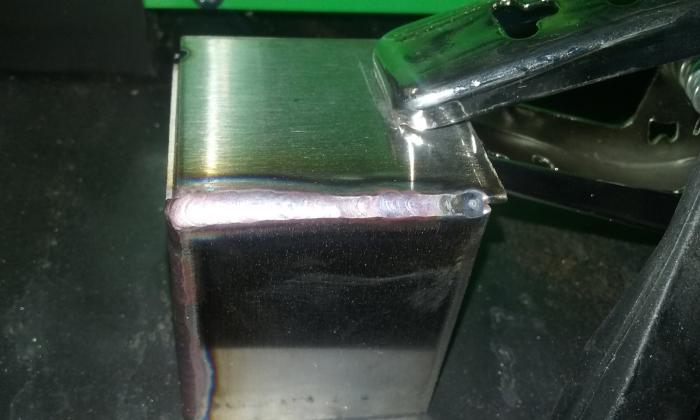

I tried bumping the amperage back down to 40 to start this weld off.....just to make sure that torch angle wasn't the problem. You can see lack of fusion on the right side where I started welding and I was able to rule out torch angle as being the culprit. Bumped it back up to 45 amps and everything went smoothly until the end when torch angle caused LOF. Flipped it over and discovered that torch angle becomes less critical when washing thicker 16 gauge metal into the joint than it was with the thinner 18 gauge metal.
Any other time that I've worked with thin lap or T joints heat input was never this critical and I always had plenty of extra amperage at my disposal.
This is one heckuva learning experience and I feel as if I will be able to weld almost anything without much problem once I get a good handle on this. I am already able to make passable welds on 1" tubing, with either hand and from any position. Learning stainless seems to be every bit as hard to learn as it was when I was learning to turn the torch with every single dab of wire when welding tubing that small, in compound angles overhead (when I made my tig cart).

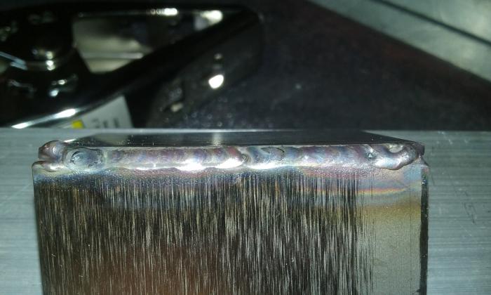

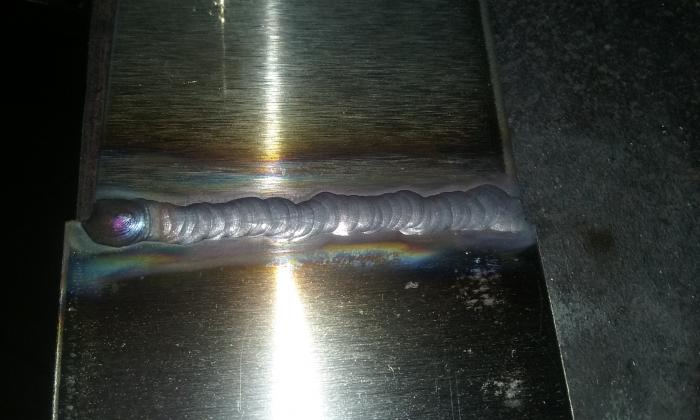

Square butt, both pieces 16 gauge, 40 amps with 1/16" 308 filler wire.
This went well, sort of. There was a bit of a groove at the left end of the weld from when I deburred the metal. Started getting out of the peddle toward the end of the weld and got cold lap.
I knew that I should have cleaned the back side of the joint before welding. I let it cool off and bumped up the amperage to 45. I'm guessing that it was the oxidation that I failed to clean caused the puddle to be sluggish and not want to follow the torch.
This was welded flat sitting atop 3/8" hot rolled flat bar.

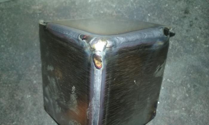

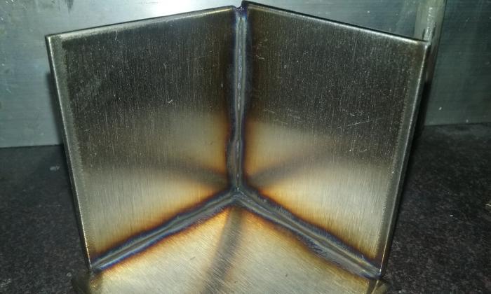

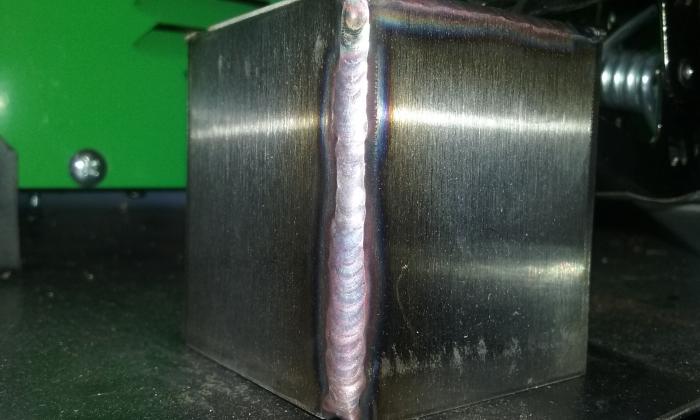

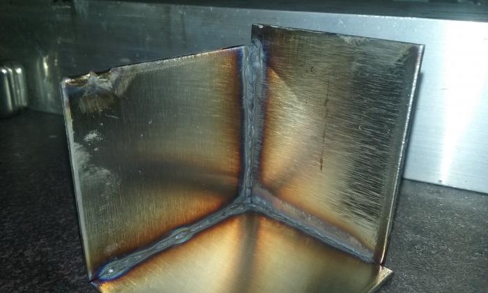

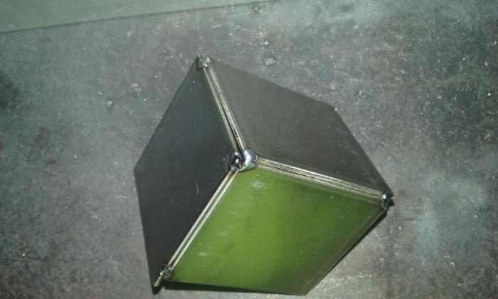

Half cube, outside corner joints, 16 gauge, tacked with 50 amps, welded with 42 amps.
Tried this first on 18 gauge and made a mess out of two of the three joints. The last joint was buttoned up rapidly with a smooth movement. The first I tried to dab filler and the second I just tried little circles. I forgot to set my amperage and was working with 40 amps when I should have been working with 35.
With the second cube I had some bad fit up on one side and realized that I needed a game plan to compensate for that. That particular joint was welded left to right in the horizontal position, torch angled down to wash metal into the gap, counterclockwise circles. The other two joints were welded right handed, uphand, 45 degree angle, counterclockwise circles. I am actually happy with the way that this last one turned out. You can see a spot in the middle of my last weld where I outran my heat and had to go back and tie it in. The fit up on the last weld was perfect and allowed me to travel at a faster rate than with the first two welds.
I realize this isn't anything to brag about but it is a very real accomplishment for me.

- Finished.
- 20160619_185518.jpg (30.46 KiB) Viewed 2009 times

Looks like its coming together for you. You are getting good penetration and colour. Just seat time now.
Some points:
-fitup is key. No gaps. As soon as you get a gap it turns to crap so you must stop if a gap opens up do whatever it takes to close it up.
- use plenty of speed tacks to hold it all together.
- play around with speed tack settings to keep them as small as possible so you don't see them once consumed by the weld.
- Start and finish with filler to prevent corner burn back.
- with more practice head towards keeping the bead as small as possible. This way, once smoothed over and polished the weld disappears and a corner looks almost like a fold. If you get that good, you won't be short of work in food/sanitary, architectural, marine and auto craft industries.

Very good info. My goal is to be a weldor.....driving trucks for a living really bites the big one.Coldman wrote:Looks like its coming together for you. You are getting good penetration and colour. Just seat time now.

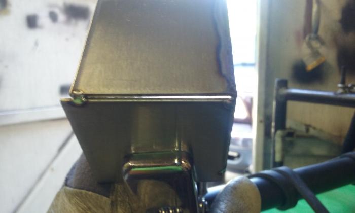

18 gauge, 35 amps.
This was my third attempt on this gauge. I tried to turn the gas up from 15 cfh to 20 cfh and it didnt want to tack.....just blew back the edges. Went back to 15 cfh and everything went just fine. I think by looking at the dull gray color that maybe 30 amps would have been more appropriate. Looking at the penetration on the back side tells me the same thing. I probably could have gotten away with it if I hadn't been holding such a tight arc. I don't think that I was ever anymore than 1/32" away from the metal with any of the three seams.
The colored portions of weld are where I had to add filler wire to fix the argon blowouts. I speculate that too much gas pressure caused the weld puddle to push back instead of tying in. Whatever the case, turning the gas back down caused all to be right again.

I see progress in those pics so good job! It takes seat time, torch angle is very important fitup is more important on outside corners. If you get a seam opening up you have to get filler in there quick on ss or it turns into a mess super quick.
What I see is your a little low on amps and your moving too slow....but moving faster comes with seat time. I'll try to take a video tonight I can post on my IG account.
Your on the right track, keep burning rod!
