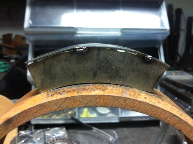

GreinTime wrote:Jonathan,
By saying it's setup for 8" pipe, are you implying that the radius of the 'C', if you will, is the same as the outside radius of an 8" pipe?
GreinTime,
Here is a picture of how it sits now. Have you ever made these or something like it before?
trailing shield curve.JPG (109.9 KiB) Viewed 2602 times
GreinTime

Honestly man I can say I've never welded anything where I needed one. Hell I've never even tried to weld stainless or titanium or anything haha.
