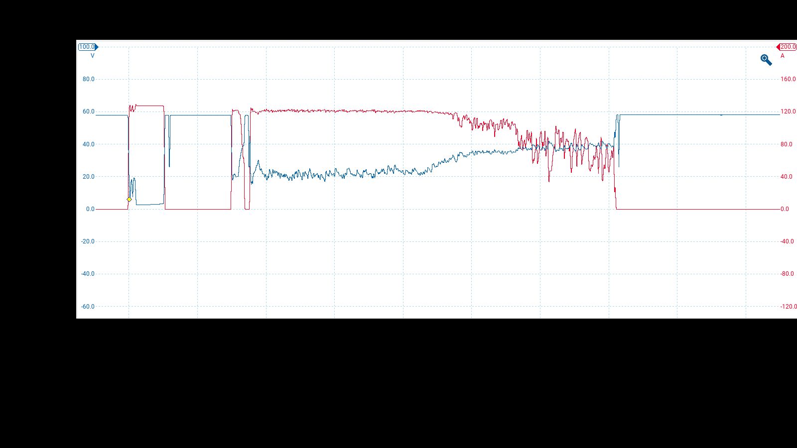

Hi Arno,
I had a look at how voltage and current vary on the Manual Metal Arc (stick) process.
I turned off arc force and hot start and used a 6013 rod.
Here, I start with a tight arc and then part way through I make a longer arc. This was at 125A.
On this run, there is a negative slope to the characteristic: 121A at 21.8V, and 104A at 35.6V. That would give a slope of -40 degrees.
Volts vs arc lenth 1.jpg (77.04 KiB) Viewed 4967 times
Here I start with a tight arc and then alternate between a tight arc and a longer arc. The current was lower at around 94A. At 20.0V I have 93.8A, and at 31.5V I have 91.6A. That gives a slope of about -80 degrees. Almost like falling off a cliff.
Volts vs arc lenth 2.jpg (156.67 KiB) Viewed 4967 times
I follow Jody's rule anyway: set the current so that the rod does not stick on a tight arc, and then keep a tight arc!
So there’s 2 points on the V-A characteristic curve with the tangent at those points. Clearly, I could take measurements at more (different) current settings, between, say, 70A and 140A and construct a much more detailed characteristic curve.
