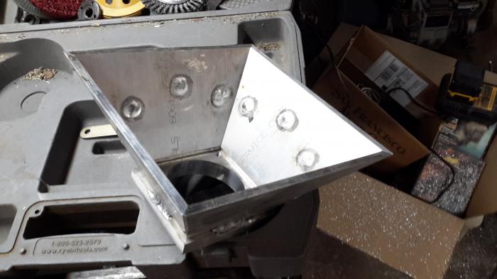

Very cool. I needed hoppers, 3 for autobag machines. I did the solid model then drilled 3 holes in each of the 12 blanks, made a tapped block to go in the Haas mill vise, then a .5 inch ball nose end mill to form the angles all 4 sides while screwed flat on the block in the vise.
Fit up looked great. I found when filling the holes which had served their purpose it doesn't matter if I dipped the tungsten....just glopped the aluminum in. Everlast 164 combo at full amps with pedal control. I'm not done sanding the glop flat.

- 20170129_014635.jpg (37.32 KiB) Viewed 2087 times

I really don't 100% understand what part this is in the pic but I do know that welding aluminum without filler is looking for trouble with cracking. YMMV.nelson wrote:sketch1485715695639.pngJust thought of this. I don't have time to try it. I have to grind down the bevel to weld it....but if I saw cut the notch I might be able to run a bead along the corner without filler? Quick and easy? Know what I mean?
I'm not an explainer... the arrow points to the area which would act like filler when welding a box like structure as my recent photos have, only in a pyramid shape.
My thinking is I could hit such a corner with high amps, move fast and produce a good tight joint in the 1/4 stock. No dimes needed. It's just for a good seal. The structural integrity comes from other welds with proper penetration, etc.

Are you saying because of the notch (I would call it a square groove) and high enough amperage the corner would become the filler?nelson wrote:I'm not an explainer... the arrow points to the area which would act like filler when welding a box like structure as my recent photos have, only in a pyramid shape.
You can do this if the groove location and depth are such that the corner would be consumed at the proper amps

Yes Richard exactly. I know the way aluminum wants to ball up. I'm thinking this could come in as a handy timesaver.
