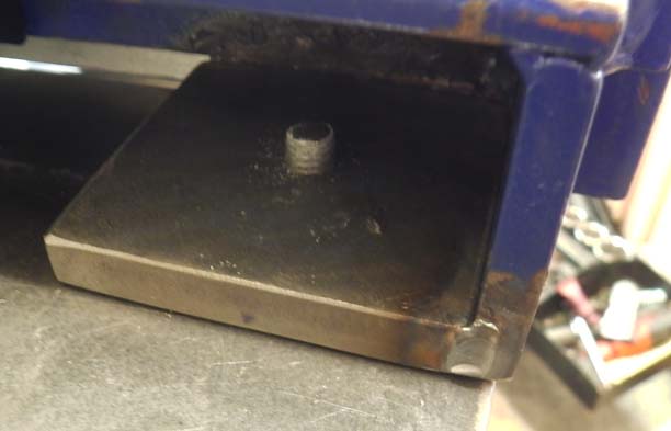

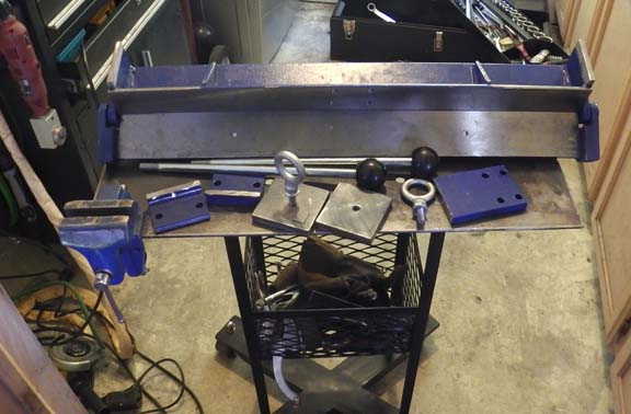

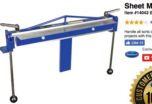

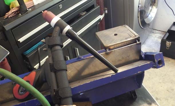

Here’s a quick one. It’s an off-the-shelf 20” Eastwood metal brake that I got on sale for $130, or less, free shipping, no extortion paid to the involuntary State organization.
My indoor space is very limited for welding. So the first thing that I built when I finally decided to upgrade to an AC/DC TIG unit, a couple of years ago, was a very compact welding table. And I recently decided to add a rudimentary metal brake to my little workshop, so I selected this particular one because it seemed a perfect fit, with some slight modification only, to integrate onto the compact welding table and to also be able to be quickly removed with no tools, when desired.
So, I’m happy to say that it swiftly (about 3 hours) came out as well or better than I thought it might. And due to the division-of-labor, the $130 was a nice value and time-saver over designing and building a custom/homemade brake. I mean, it’s great to see people making their own stuff that way. And that’s what I did for the compact welding table, because there was nothing off-the-shelf that suited my space and purpose at any price, so I did take the time for that project. But this metal brake was, for me, an easy choice. It’s not a finger-box style one, but for what I want to do, it’ll undoubtedly do fine for two or three sides of some .100 or .125 aluminum diamond plate stuff that I like.
Here's a late entry: I was curious about how I would go about making a softer radius for 90 degree bends on aluminum, to prevent chances of cracking. The fancier metal brakes have an adjustment for that. But for this simple brake, just using C-clamps to back-off the bar edge, instead of using the mostly-fixed T-handles, gives all the adjustability I'll probably ever want. And I think I could even use this thing like a finger/box brake too, for smaller stuff, by just using deep-throated C-clamps and some bar-strap segments. Wheee... this welding stuff is fun!!!!

Pretty slick, Christian. I particularly like the threaded lifting eyes for bolts, so hand-tight is tight enough, and easy to loosen (and damn near any object that will fit the hole can be wrench if it's stuck).
I also agree with the purchase. Why re-invent the wheel when that was so economically available?
- C. Livingstone
Hey,
Thanks for that, Steve.
Yeah, the unit came with those clever, pop-pin-like T-handles for clamping stuff down, so I thought I'd try to keep the mounting hardware a similarly elegant solution too.

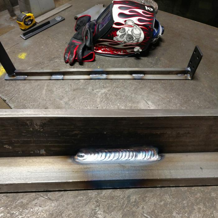

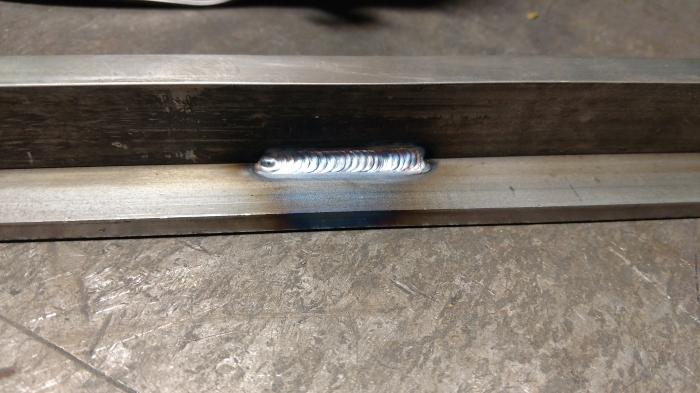

Just a little carbon steel, haven't been taking a ton of pics of stuff lately.

In one of your pics I see a pair of gloves, do you like those? I have the same pair I think but had a hard time feeling the filler rod. I am just learning though. My "go to " gloves have been a pair of split deerskin that are really soft but don't do much for heat when you get down to the nub of the filler rod. I bought that pair thinking the leather on the fingertips would give me more grip on the filler but they seem to be too thick for my little skills.Rick_H wrote:Just a little carbon steel, haven't been taking a ton of pics of stuff lately.
They are the HD Weld Porn gloves, I love them.... Favorite gloves right now. They fit great, hold up very well. I feed .030" wire with no issues, I find the feel nice. I also have the light duty gloves, no issues there either. I use to wear the kidskin Tillmans or the Millers, just wasn't happy with the life of the gloves, but they worked just fine.Jakedaawg wrote:In one of your pics I see a pair of gloves, do you like those? I have the same pair I think but had a hard time feeling the filler rod. I am just learning though. My "go to " gloves have been a pair of split deerskin that are really soft but don't do much for heat when you get down to the nub of the filler rod. I bought that pair thinking the leather on the fingertips would give me more grip on the filler but they seem to be too thick for my little skills.Rick_H wrote:Just a little carbon steel, haven't been taking a ton of pics of stuff lately.
It takes some time, I've been together welding for quite awhile.
@LtBaddLtBadd wrote:Looks good Rick, good to see you posting again!Rick_H wrote:Just a little carbon steel, haven't been taking a ton of pics of stuff lately.
Yeah, looking forward to doing it more again, been a messy few months in life. Happy New Year Rich! I like my WTT brothers.
