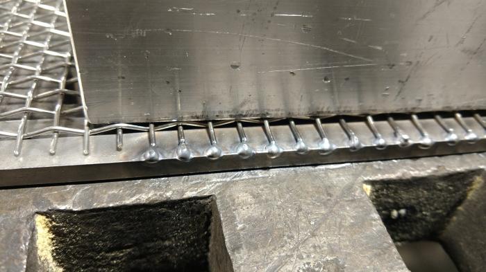

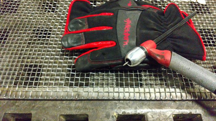

Little job that tested my patience and skill...
304 screen .050" diameter to 303 bar stock 1/4"...was 548 welds! Superior cup...

I know you had fun with this one :lol: why was 303 bar used??

@LtBadd Man I can't wait till the rest of the shit is gone...only because it was here, to tell the truth most mechanics I work with couldn't tell the difference or even care about the difference. I was mad, you give me something difficult to weld anyway by design, then give me 303 for the frame.... thanks.
When I start mentioning different filler and material grades and why you use what I get the "your just he welding nazi look or you think your better then us look" at time I feel I'm the only one that cares.
An old vendor slid 303 in instead of 304 at a cost savings, the buyer had no clue what the difference was and the vendor said "it will preform the same".

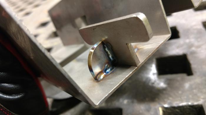

Nothing exciting, I had 14 of these steel legs that needed welded to plate.
Used ER70S-2 and ~180 amps

Was Tig mandated for these? To me thats totally Mig territory.
exnailpounder wrote:Was Tig mandated for these? To me thats totally Mig territory.
In a way, our MIG unit is in storage. :shock:
