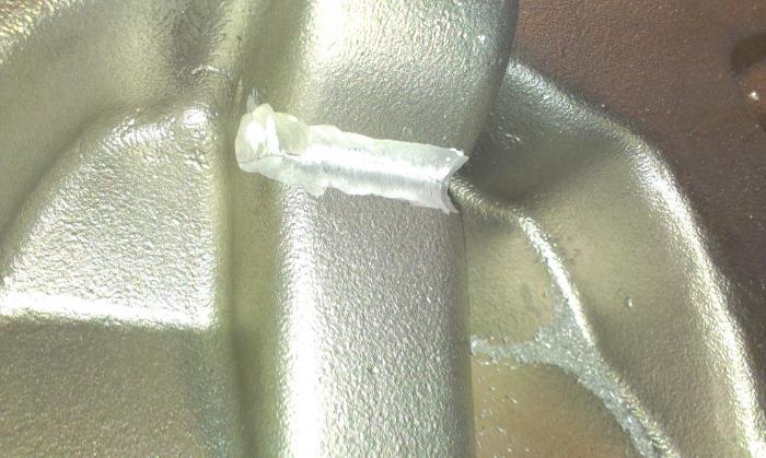

A cracked Olds intake manifold that I repaired.

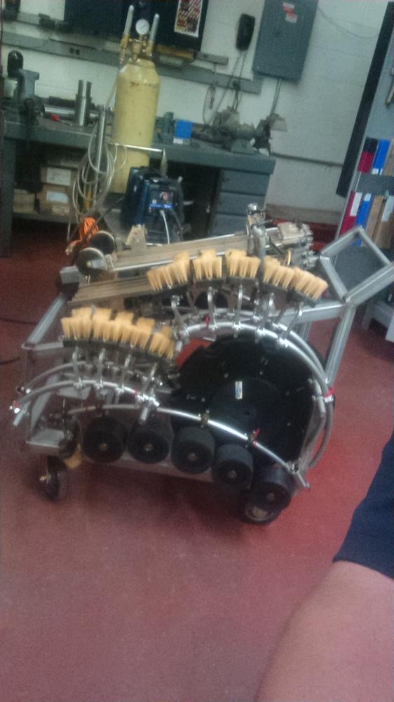

Made a cart to hold all the parts to a labeler at work to prevent damage. I made one a year ago and damage is own 98% just have to cap somethings off and do the finish work.

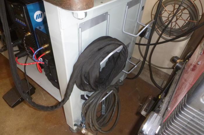

Some hanger-uppers for torches and work cables on the end of my weld bench.

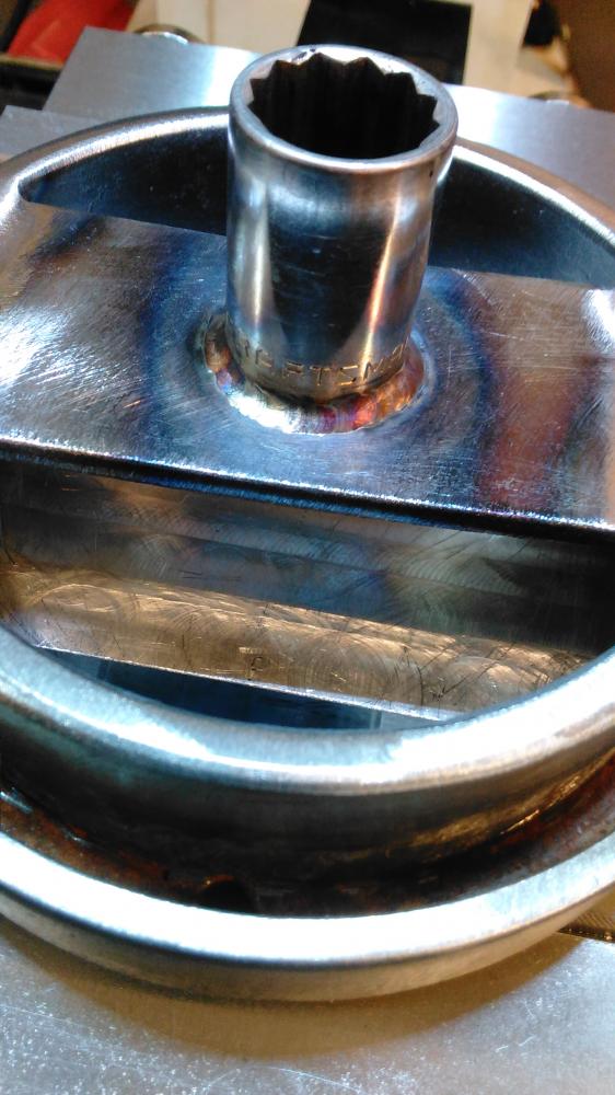

Melt all the things.

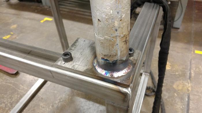

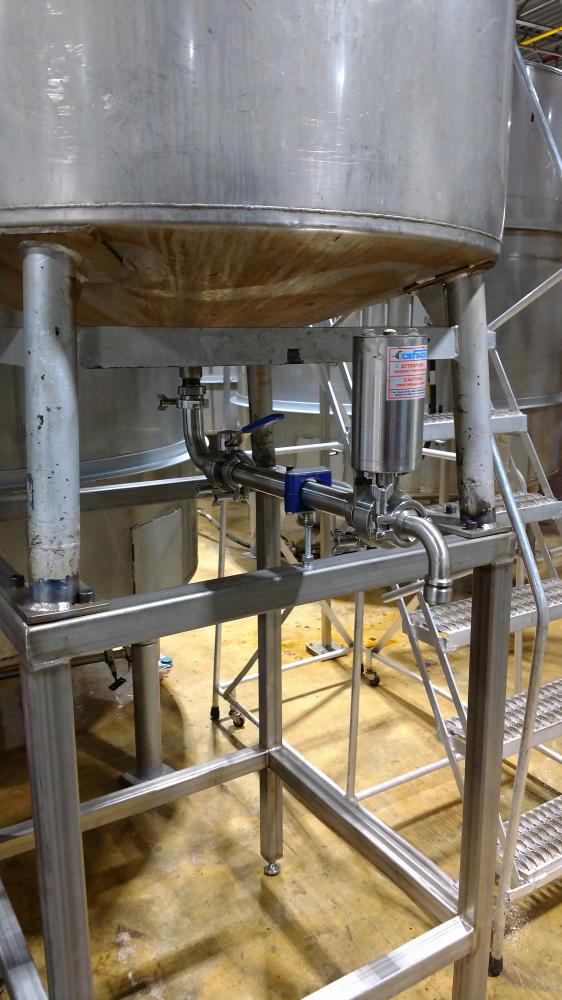

Got my fittings welded in, tank and stand complete now to add some process piping and a filter.
- 2 passes, 309L steel to stainless on the legs.

- Inside welded, grind smooth and polish...happy since I was leaning down inside the tank upside down.

Stand mocked up in place, need to wait till the tank and cleaned then Ill paint the stand with some Steel-It and they will sanitize and put into production.

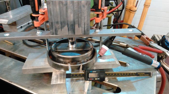

- My setup today....

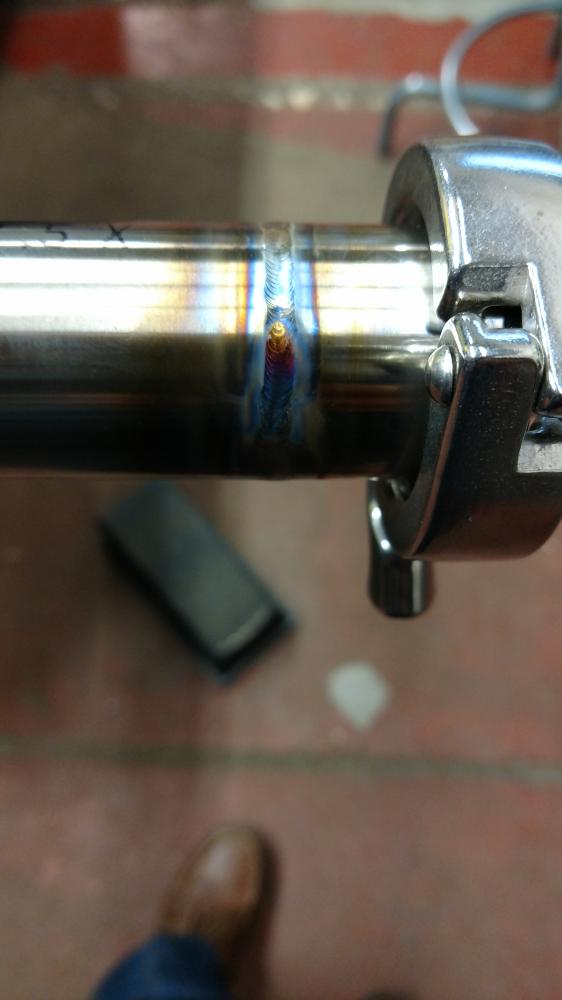

- Polished out, weld nearly disappears
- IMG_20160814_195522.jpg (30.48 KiB) Viewed 3044 times
- 316L, sanitary, back purge
- IMG_20160814_194439629.jpg (39.72 KiB) Viewed 3044 times
