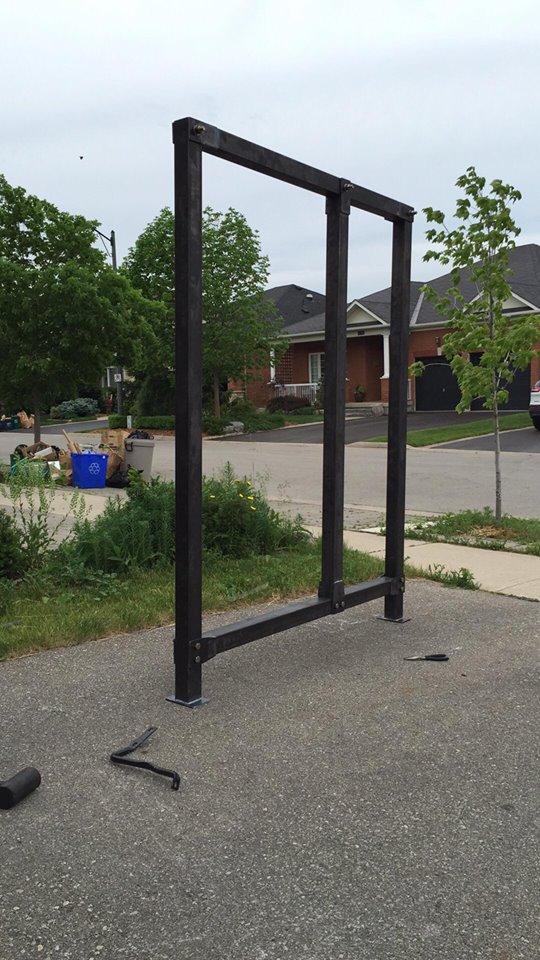

Then finally on to my own stuff. I have been building a home powerlifting gym in my basement and haven't found a power cage to buy that was remotely what I wanted, and the ones that come close are 4 grand or more. So, off to build my own. Cost me 500 bucks in steel and 100 in grade 8 fasteners. I thought I'd be done in 2 days but wasn't even close. Ran into several procedural issues but now that I know what to do, the other half should go smoother.

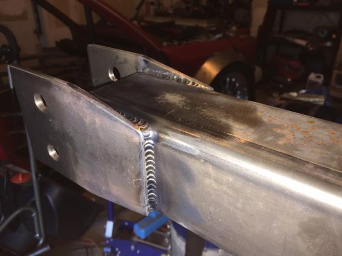

My original estimate for building my squat cage was adorable in retrospect but the delays are all my fault for wanting to go nuts with it (big bulletproof design, every beam being a bolt on, and using only TIG). The TIG practice is really paying off, I'm feeling more comfortable with every weld and I think the results show it.

Thanks Kym! I'm currently planning to paint the uprights which will receive the safety pins black and the rest red but part of me wants to polish up the metal and leave it bare to see the welds better. Definitely my best work yet. I've made welds this good before but it would be the exception. Every weld on this cage is nice, so I'm heading down the path of "practice until you can't get it wrong", which feels great!
Mask your welds before you paint. You can probably find pinstriping at any auto paint store that will be perfect for that job. Then you can clear coat the welds afterward. That would look cool as heck.BigD wrote:Thanks Kym! I'm currently planning to paint the uprights which will receive the safety pins black and the rest red but part of me wants to polish up the metal and leave it bare to see the welds better. Definitely my best work yet. I've made welds this good before but it would be the exception. Every weld on this cage is nice, so I'm heading down the path of "practice until you can't get it wrong", which feels great!

I welded up a race bike stand awhile ago and for once in my life I was actually happy with the welds.
So I just gave the whole thing a thorough cleaning and then sprayed it in heavy duty clear coat - you can see the welds as they were finished, complete with a touch of rainbow oxidation here and there. It's funny, people love it and it's clear to see (pun intended) that it's a hand crafted stand, whereas if I'd sprayed it black or red it would just look like every other stand.
I say if you are happy with your work - and you certainly should be happy with that cage, it's beautiful - show it off.
