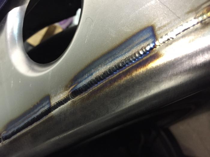

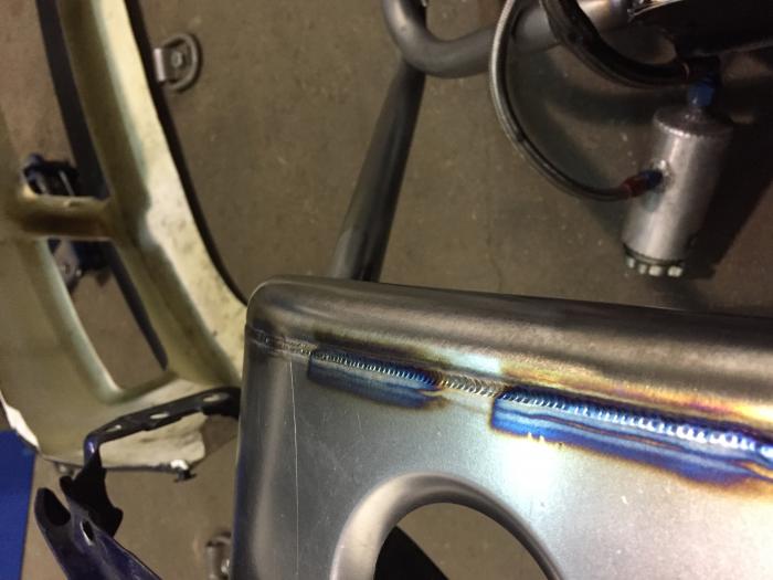

Rick_H wrote:Screen repair...in most cases I'm making the wire or gap up with filler.
Good job Rick,
I'm curious as to why your tungsten is discolored? Does the Pyrex gas lens setup work as advertised and what flow rate do you use?
Rick_H
    Sat Feb 08, 2014 1:50 pm
    PA/MD
Good job Rick,
Too much stick out not enough flow....had to move it out and inch or so to get around a handle for one spot..weld stay covered but the tungsten turned blue. I usually weld with a #8 gl set up, 2o-25cfh works great and is where my flowmeter was set with my other torch. Cranked it up to 40cfh...after that.

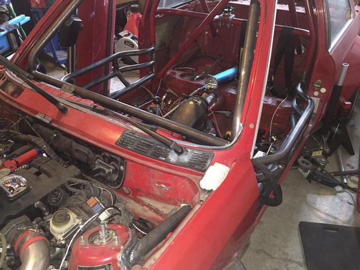

Big milestone today, my first cage is done! Just want to add some gusset bars and call it - between the hoop and the forward bars and one in the vertical plane of the strut tower bars. Instinctively I thought it would be best to brace it laterally but a racing engineer told me that this bar will primarily see vertical load.

So what race series are you doing? I know in Lemons, this would fail tech because the belt bar is offset from the main hoop. It would be fine if it was just for the belts and there was a second structural tube connecting the main hoop to the diagonal lower down though. As it is, there is very little that would keep the cage from crumpling inward at the bottom. We ended up with a belt bar in addition to the cross on the diagonal so it is a common enough issue. Just best to deal with the possibility before you get to the track. Or bolt the seat in for that mater...

Not for any specific series, just for my own needs. I do plan to run it in time attack. I've been thinking of adding a bar across the trans tunnel. Just curious, what does it say in the Lemons rulebook that would make this style harness bar illegal? I've seen many SCCA and Chump teched cages built this way, not always with the whole bar being offset but at least the driver's half. Especially Miatas:

All the race series have different rules and sometimes you can rule spec a cage, other times you can't. E30s can pretty easily pass lemons and chump though. Lemons will let some things fly when there really isn't a way around it but they are usually regarded as being more strict then Chump. The miatas are notorious for being hard to cage but they really dislike compound bends when not absolutely necessary. I went back through their written rules and other than their diagrams all showing a straight bar linking the main hoop and the diagonal. It may not be well expressed but I've welded in some secondary belt bars at the track for people that failed tech for that issue so they do care.

I've tried Chump and I figured out an extremely competitive recipe but it just wasn't for me. Endurance racing sucks and so is building to class limits (just my opinion of course). I build my car how I want it and have fun. Thankfully time attack is very wide open once you get up to the top classes and I wouldn't risk this car in wheel to wheel anyway. But the cage has been long overdue but I wanted to do it myself as the rollbar is the only thing that someone else did for me and I regret it (but as I said some pages ago, back then welding was a black art for me). But the car gets up to very exciting speeds with alarming urgency so before I push it any further I need to make it safer (around 1000hp, breaks traction in 4th with 335 slicks):
https://www.youtube.com/watch?v=c3EXZtGs9jw
Right now my planned additions beyond the kit design (well, the sill bars and tie ins were already exceeding the kit design, it was meant to only have the two S curved bars which I don't like):
-gusset bars between main hoop and forward bars
-gusset bars from strut tower bars to forward/A pillar bars
-diagonal across the rear stays to meet the node where the hoop diagonal is
-bar across the base of the hoop over the trans tunnel
I'm also considering adding bars from the windshield bend of the forward bars down to the bottom of the forward bars, or the forward most node of the nascar bars (visibility permitting).

Oh, wow. That is a monster. I can see why endurance wouldn't be your bag. Lemons is more or less full contact racing lol. I think we average about 3 hits per race in the 5-10 mph category and a solid hit about every other race. Might be part of why they take the cages seriously... Fixing that kinda damage mid race is part of the fun for me and it is part of the game when racing rusted out crap-cans :)
Seems like you have a pretty good plan for it. Given your speeds, you might also consider a footwell bar going from the front hoop to a spreader plate near the clutch. It'll help keep your feet a bit more intact in a serious front impact.

Yes, sorry forgot to mention those, thats my next order of business with the gusset bars.

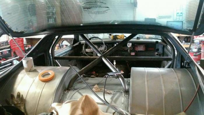

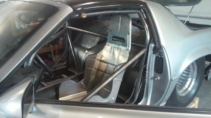

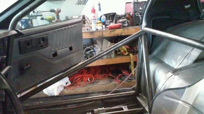

Nice job Big D! I too have been working on some roll cages. Not as nice as yours but it has been fun. Here are a couple of pics. Thanks John.

Welder cart looks good. Finished all the tubes today, now lots of tig welding. Thanks John.

Looking good Hollywood. Are you not required to run a X in the door?
