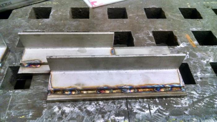

Thanks. This one came out better. I was in a rush on the first one and had the heat screaming hot. You kinda get tired of looking at these after you weld 30 or so.

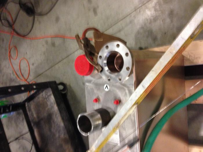

Customer ordered in a replacement heat exchanger from Germany took 8 weeks to get. But he failed to tell them what kind of connections he needed on it. It's body is 316 SS brazed plates. The flanges are 409 SS there brazed on to the body and the stub in the pictures is 304 SS also brazed on so it's filled with water and was welded in position to keep from over heating the plates or any existing braze joints.
The existing flanges are 409 SS welded to 2-1/2 in sch 40 carbon with 309. The old flanges that had to get put on are some kind of cast steel and of very poor quality metal. That was a 70s2 joint. The other stubs are 304 to 316 using a 308 rod and the finishing touch was the OA braze joint to copper for the refrigerant side. It's 316 to copper with a 45% silver braze rod.

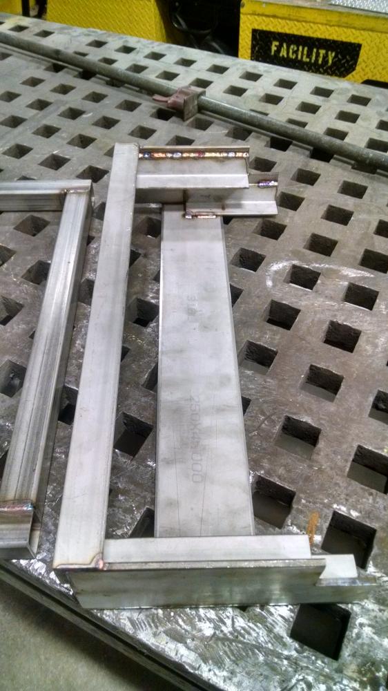

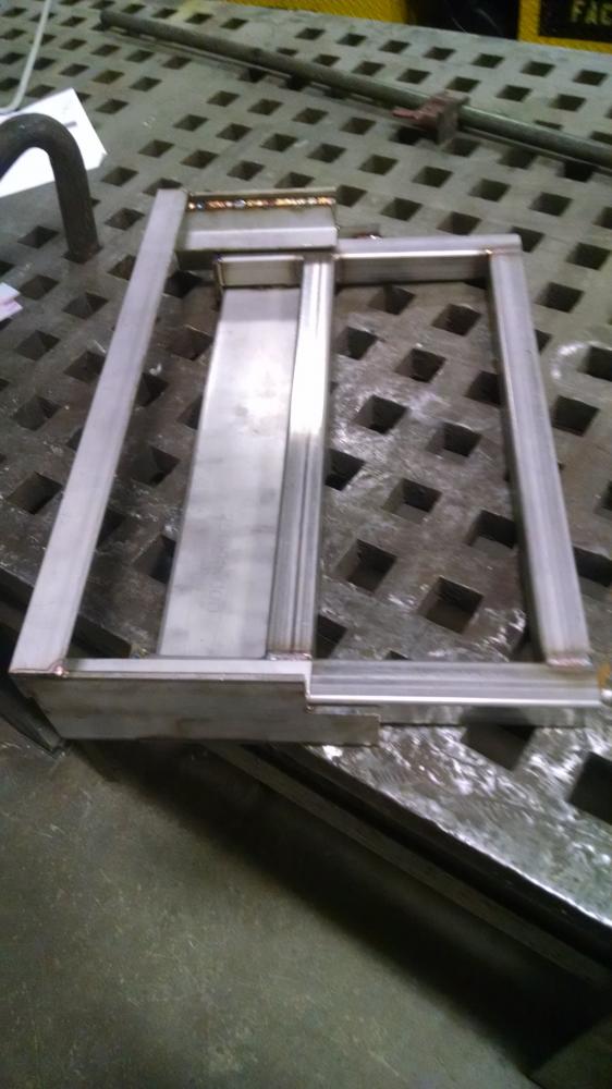

Made a slide out step to fit an existing frame the guys were standing on till the safety officer saw it :o All out of stuff I had laying around, install tomorrow...

Got it all installed
In
In
Out
Out

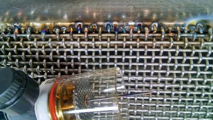

Screen repair...in most cases I'm making the wire or gap up with filler.
