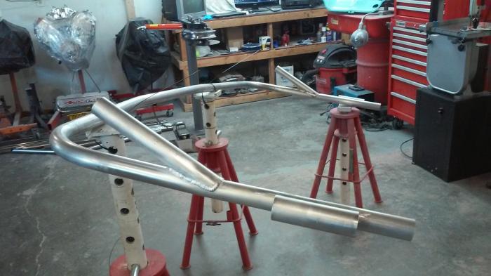

Welded this aluminum boat rack for fishing pole and net storage. Had some trouble with the tubing bringing lots of crud up into the weld. never had this problem. Any ideas? Thanks John.
