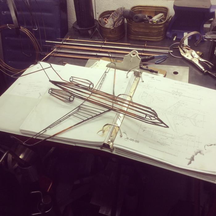

I worked at finishing a desktop wire model of a Grumman Gulfstreamer G-550. It's going to one of my corporate customers. It's been a while since I posted anything on this forum so I thought I'd better let everyone know that I'm still alive and kickin...
- image.jpeg (61.56 KiB) Viewed 2068 times

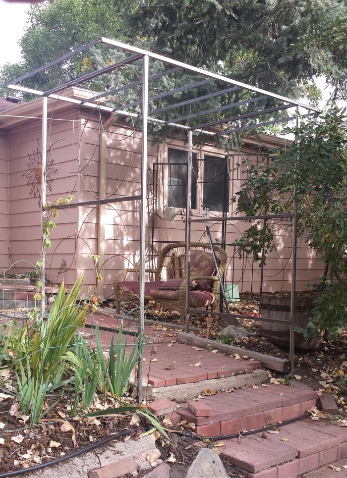

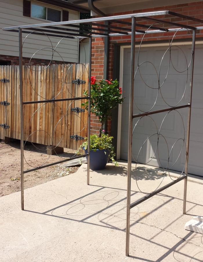

Finished up my first for pay arbor/trellis. It was my first project with my new blue 211 MIG (transformer version). Most of it is 1" sq, 1" bar and 1/4" rod hrs. The rod I bent in circles using a plywood template (PITA). I've already got an order for another of similar design and I would rather use a rod roller if I can find one that works and is reasonable in cost. I made it in three parts. The top has small 3/4" sq tube chunks welded down that sit inside the end pieces. Next time I think I'll TIG those connector pieces on so I don't have so much weld to grind down to make the fit up cleaner. The vines don't care but I do. Next time I'll get close ups of the welds.
In my far past I stick and MIG welded stuff on the ranch. Generally thick anything when you are repairing tractor implements. Learning to do thin steel was a lesson in patience for me along with lots of practice.
- 20150921_164649.jpg (183.67 KiB) Viewed 2325 times
- 20150823_121330.jpg (118.39 KiB) Viewed 2325 times

Have you considered making them modular so they could be shipped flat on a pallet and put together by anyone. Some sort of pin and socket joints maybe. Imagine you could sell lots of them it looks nice.
