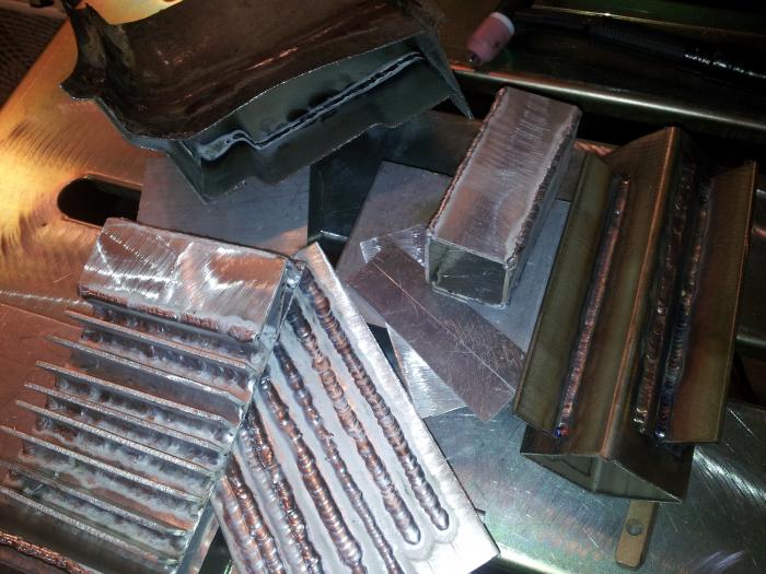

Made alotta scrap , practiced a bit of everything today, 6061 , 304 and sheet metal body panel. The thing on the left is a dog leg body panel , cut off 2 extra pieces from a junked jeep so I could practice first joining them back . Thin body panel was pretty difficult ...and starting the inside corners on the aluminum's so challenging...so I cut a bunch of little pieces to keep practicing just starting the "T" joint . I keep watching Jody's Alum 2F T joint vid , great vid . . . notice my "dipped" tungsten in the background ...haha
- LottaScrap.jpg (65.82 KiB) Viewed 2172 times
- MosquitoMoto
Location:The Land Down Under
Nice work, Sub.
Yes, I've been viewing and re-viewing Jody's Alum 2F joint video, too. It is pure instructive gold.

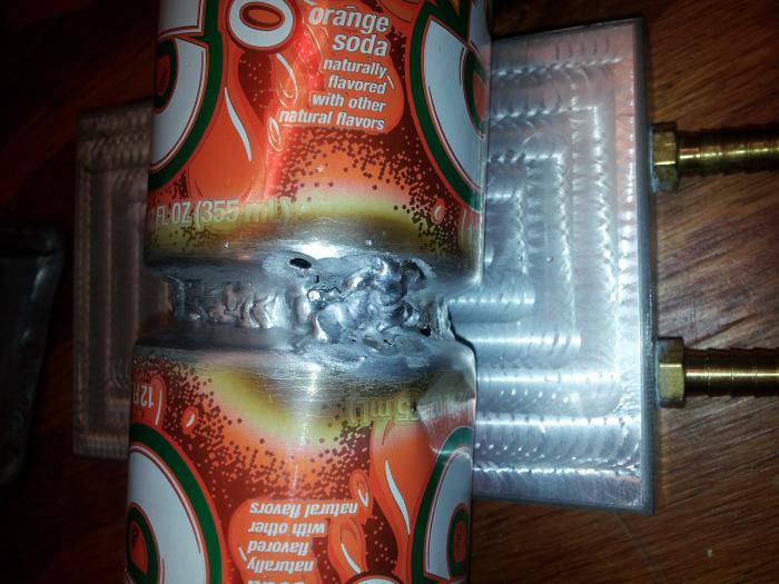

- subwayrocket
Thanks ! you guys want a good laugh ...I should post my "Pop can" mess...haha
It started ok ...then went POOF !
- 1GoodStartPop.jpg (58.76 KiB) Viewed 2172 times
- 2PoopPopCan.jpg (59.81 KiB) Viewed 2172 times
- MosquitoMoto
Pete -
Thanks for the tip, Pete. I am working on aluminium motorcycle frame beams of 2mm thick at the moment and starting to create welds I'm half happy with. They are strong, just not quite as pretty and even as I would like.
(I will post pics soon of some of my beam frame repairs).
I do reasonably okay on aluminium down to about 1.6mm as long as I have some kind of heat sink backing. On small pieces I find the heat gets out of hand quickly.
Out of position stuff is a real challenge for me right now. Struggling with my big size 26 torch. See me blaming the torch?
Subway...I'd be very happy to be able to weld cans at all, regardless of finish!

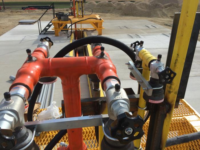

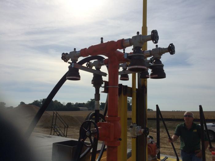

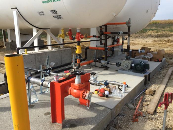

Awesome job. Lots of different joint methods. Is this a fertilizer project? What is the purpose of the orange dye in the ammonia? What's the temperature like there where you are welding? What schedule pipe was used?. Sorry for all the questions, my interest is piqued.
It is for fertilizer. There ammonia is allowed to have up to 20 percent water in it. Not good for refrigeration. The pipe is all sch 40 seamless. 3 in is liquid line 1-1/4 in is vapor line. And there was some 2 in that was for pump auto bypass. And an extra 2 in hand valve that allows for them to use the pump to transfer from one big tank to the other if they ever need to. There is also a semi header for filling the system. The 2 big tanks hold about 3-1/2 semi loads. The pump pushes liquid down to the filling stations were they load out small tanks for applicators. The orange and yellow paint is just there standard way of color coding the pipe orange/liquid. Yellow/vapor. State law requires that here as well as pipe labels. Lots of valves. And lots of safety's
