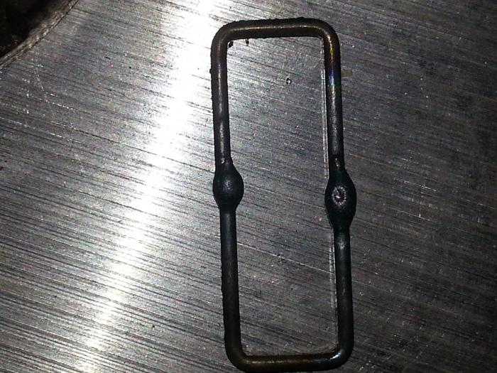

Ol maker is determined to win this thing! :lol: Nice job! I suddenly got really busy so I haven't had time to play but I will soon. My first attempt at an inside corner on the thin blades was an excercise in burning metal. Crashed and burned...literally
My try with new (5 years ago) rusting blades :lol: and sil bronze filler.
not the best
not the best
How about staples

How about welded staples. Tried to just fuse them and they burned back so I had to use filler.
