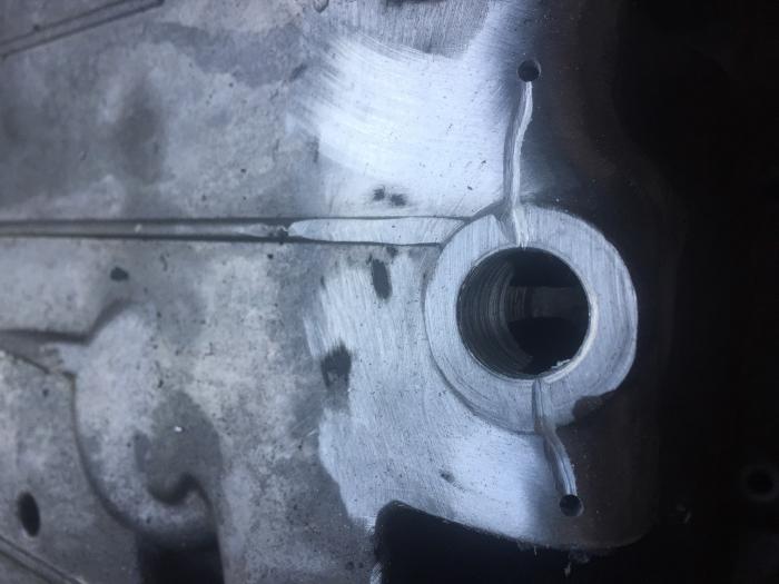

Picked this little job up yesterday. Delivered today. Everything went just as planned which was nice since it usually doesn't go that way for me. Especially on aluminum. It was very dirty and oily but it cleaned up good. It's an oil pan for chevy aveo. I didn't think to grind off the weld where the plug goes back in but the mechanic said it was fine. Had a little porosity at the starts but after I ground it out the next weld was fine.
Stop drilled
Stop drilled
Ground out with the new dremel I haven't gotten to use yet!!
Finished up
Finished up
