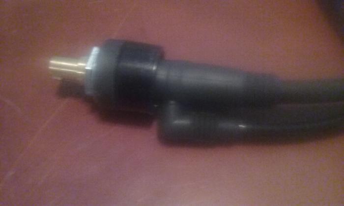

I am trying to get my Everlast PA200st setup to run in its Lift TIG mode for the first time, and I need some help finding what goes from the flowmeter to the attachment coming from the TIG torch pictured above. All the gas hoses I have seen online have the 2 threaded male ends, which will fit my flowmeter, but not the attachment you can see in the picture.
Is it a quick connect plug? Or do I need a hose with open ends to go between the flowmeter and the torch that will get a hose clamp at each end?
Thanks for helping a noob out.

Yes, the connector end on the gas line is a quick disconnect. Which particular kind of quick disconnect is not to be determined from the photo on its own. Perhaps a few appropriate measurements? In any case, I'm sure your local welding supply house will be more than able to give you assistance with this.
Thanks for the reply.
I would love to go into the welding supply shop, but their hours and my working hours line up, so I was hoping to order something online to avoid taking off work. I've looked at several online weld shot sites, and haven't seen anything that looks like it would fit. seems strange it wouldn't be a common product.
