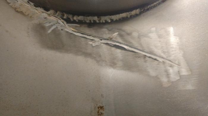

A pressure vessel repair today . Cut ,prep, fit, weld . Nothing glamorous but it's a paycheck
Coldman
    Mon Dec 15, 2014 2:16 am
    Oz
Maybe not glamorous to you but involves serious skill and experience. Good job!
Now you have to elaborate on process and procedure used please.
Bingo
    Mon Jul 03, 2017 11:03 pm
    FLA
Coldman wrote:Maybe not glamorous to you but involves serious skill and experience. Good job!
the welding process is smaw (stick) we use 7018 for the vessel. This weld is a code or stamped weld it will be QCed under 31.12 boiler code ( no under cut or any indication while they pt it) and stamped with ASME stamp .after that we will hydro the tank to 300 psi twice the stamped pressure. This vessel is apart of a water treatment plant for a power house. Definitely not glamorous but I love what I do and being challenged every day and pushed to weld at a very high standard has put me and a very fortunate situation!
