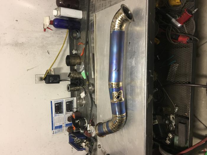

Well after months of practice, swearing and maybe a few cries I have finished my first titanium part for a customer. I know my tie-ins need work, but they have come a long way. The piece is a 3" down pipe for a Nissan Skyline GTR. After welding this up I had to do some aluminum welding right after an oh boy has my skill changed. Titanium forces me to be so focused, clean and repetitive it was a breeze going back to aluminum. I am open to any constructive criticism.

When I did practice pieces without heat tinting them the purge was great. I have my purge bottle flow meter set so the ball is just floating. The colours on the inside only happened after I heat tinted the parts first. I was using a SPW # 20 for this one. I hued the Arc Zone monster cups in the past. The #20 cup has better coverage than the Monster #24.LtBadd wrote:Did you get a good purge? I'd like to know what gas lens you used? Has to be difficult, I assume you would weld and then let it cool, must have taken awhile

To start I did but I came to the conclusion that heating the pie cuts first was hindering my fit up so I had to redo one of the sections again.zank wrote:Did you do all of the coloring after welding?
My concern is that all of the contamination from heat tinting gets dissolved into puddle and surrounding HAZ. That's why it appears the tint "disappears" from the weld area. The contamination is going into the interstitial spaces of the crystal and the surface appears "clean".
I know that there are norms for every industry. And I know people like this look in exhaust applications, and it's the norm. Is it not acceptable in your industry to let the coloring occur naturally? I would think the engine vibration would make it desirable to do everything by the book to have as strong a weldment as possible. But I am a worrier.

So basically from what you're saying and what I could find on google is that pretty much every weld on the part will fail because of the application and because there was some form of oxides at the joint when I welded it.zank wrote:My concern is that all of the contamination from heat tinting gets dissolved into puddle and surrounding HAZ. That's why it appears the tint "disappears" from the weld area. The contamination is going into the interstitial spaces of the crystal and the surface appears "clean".

It's not that it will fail, but considering Senario A: part welded with alpha-case oxidation on surface vs Scenario B: part welded without such oxidation, Scenario A will have a much higher risk of failure due to the embrittlement that will occur.Skylineauto wrote:So basically from what you're saying and what I could find on google is that pretty much every weld on the part will fail because of the application and because there was some form of oxides at the joint when I welded it.zank wrote:My concern is that all of the contamination from heat tinting gets dissolved into puddle and surrounding HAZ. That's why it appears the tint "disappears" from the weld area. The contamination is going into the interstitial spaces of the crystal and the surface appears "clean".

That said, it should be ok, unless the engine is shaking violently all the time, or twitches a lot on gear shifts.
Edit: Hmm, I just re-read the first post and I thought it was an intake pipe, but it's actually a downpipe that will connect directly to the exhaust. Would I use something like that if it was my car? Maybe. Would I hand that to a customer? Not a chance.

No, that's not exactly what I'm saying. We can't say for sure if it will fail in your particular application. I just think it's best to do everything as clean and by-the-book as possible when it comes to titanium. It gives you the best shot at making a weldment that will last.
