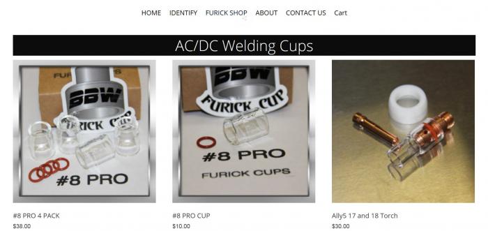

jernigan78
    Thu Apr 20, 2017 4:20 pm
Aloha guys. I almost always use a gas lens. Tried it when I first started to tig and never went back. M. Furick now makes clear cups that can handle being used for AC. And let me say they are sweet. Makes it so much easier to see whats going on. I also use Furick cups a lot for stainless, and the coverage is the best. Pics below are all with clear cups/gas lenses.
#1. the first test run on aluminum when I got my Dynasty. Pretty much just playin around and getting a feel for the machine.
#2. Some leveling feet I made yesterday for a new milling bench im making. Only running 15CFH gas. almost no color.
#3. Screenshot of the M. Furick website showing his ally cups. Good stuff. (and no I don't work there, haha) http://furickcup.com/furickshop/
furick ally cup.JPG (31.49 KiB) Viewed 2344 times
leveling feet.jpg (186.34 KiB) Viewed 2344 times
jernigan78
ok... reverse the order in my previous post. lol. They came out in the reverse order of what I uploaded them in.
