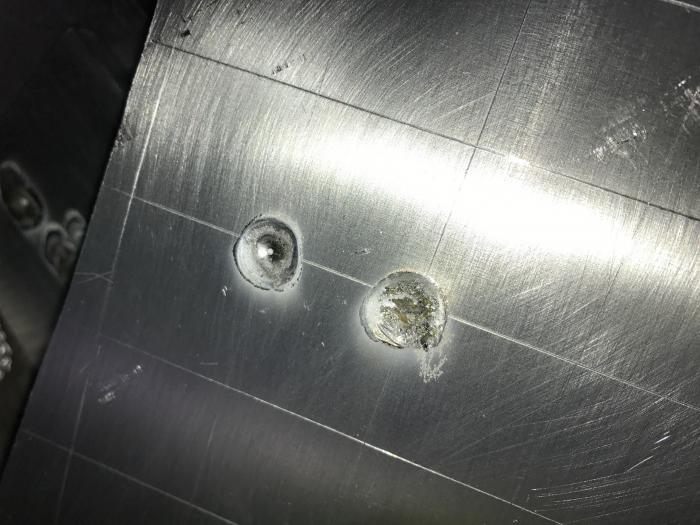

So I'm welding some alloy and it's going ok-ish co spidering I'm hopeless to begin with. The Half way through a decent weld it turns to crap and I notice the ball on my tungsten pulls to one side and almost looks like there is a split in the end of it....
I then go off regrind and spark it up on some scrap and it's just not right... so I grab another tungsten 1/8 blue, and do the same thing and notice it's just not pooling nice, what can cause this
The two puddles are around 80-100 amps and 75% bal and the lower one is when I try to add filler, it's almost like the filler is absorbed under the pubble and the top layer stays crusty like magma in a god damn volcano.
Also added a pic of what the tungsten looked like after doing the two puddles
Any ideas?

It's just a bit more fussy than steel and you have to be able to read the puddle and control the heat. Your tungsten is smoked up - it should be just plain, clean silver. Both the tungsten and the second puddle (the one on the right) look to me like you dipped.
Either that, or you possibly have a gas coverage problem/leak.

From the picture of your tungsten, it is my opinion (without more details) that you are using too small a cup and too long a stick-out length. I also prefer a lower balance, closer to 65%. I see the material is pretty clean, so perhaps you can adjust it higher but only experimentation will tell you what works best for your situation.
The 2 puddles say to me, that your heating the material too long before you get the proper oxidation off. So when you add filler, it doesn't really "blend" with the aluminum, but instead blows up. What thickness material? 80-100 amps is unusually low to "start" a puddle unless the material is very thin. In which case, why a 1/8 tungsten?
Ally is frustrating stuff. It takes heat and cooks internally before it ever gives up a wet puddle. This is confusing to new welders. Romp your pedal with enough heat and get your puddle quickly, then taper off the pedal to maintain it. By the end of the bead, you may be well down on amps from where you start as the material has absorbed a lot of heat by then. But starting low is a No-No...

I know this may seem odd to say but I think your arc length is too short. You are trying so hard to keep a short arc that you are so close to the metal that instead of puddling it, you are vaporizing it. Most everybody knows when you get to close you dip but dipping usually happens when you add filler and your puddle rises into your tungsten but you can be too close to the metal without dipping. I know this because I am guilty of it myself. I don't usually do a lot of AL and I am so used to keeping a short arc on MS and SS that when I move over to AL I have to remind myself to back that arc up a tiny bit. If you are losing control of your puddle about half way through the bead, it's probably because you're getting out of position and changing your torch angle and/or lengthening your arc TOO far away. While it's true that you should get a puddle quickly when you light up on AL, you don't want it to be instantly because it mean you're using too many amps.Try turning down the heat and using just enough amperage so that you have to wait a second or 2 to get a puddle. This will give you time to adjust your pedal instead of having to "run and gun" with too many amps and having to adjust the pedal too quickly. And don't wait too long for puddle, that's just going to heat-soak your material and cause a whole other set of problems. Take the time to set up your machine and just sit there and form a puddle (no filler) then move ahead and let another puddle form...rinse and repeat. You need to see what a good arc length looks like before you start adding filler and raising your puddle.

It looks to me like you're losing the EP portion of the arc. As if you were (this can be done on a synchrowave 250 DX, for example) set in DCEN mode with HF continuous set.
I say this because I see whitish soot, but no etched "cleaning zone". This is possibly a settings issue with the machine, an internal issue with the machine (check, clean, and gap the points), or, in rare cases on water-cooled torches, a torch issue resulting from using tapwater or tapwater/automotive antifreeze when attempting HFAC. If it's the points, no worries, a clean and gap will solve it, but I doubt this is the case. If you're using a water-cooled rig, think about what's in the cooler. I chased this problem on a high-dollar job in PA, even getting the district Lincoln rep involved before we sorted it out (rental machines).
If it's none of the above and your settings are good (you said this started mid-weld, so unless someone pranked you while your hood was down...), it's likely either a machine issue or water-cooled issue. (The water-cool issue would happen to me mid-weld. If this is it, a new torch/leads is the fix, along with de-ionized/distilled water, and low-conductivity coolant, available at the LWS.)

I see lack of cleaning action, and visible oxide skin layer. Something is wrong with the polarity as was said.

Thanks for the input guys. I'm not running a water cooled torch and it was getting pretty hot when it turned bad- what tell tale signs should I look for to see if my torch is bad apart from melting?
How do I check on the polarity problem mentioned?
My point still stands, the same piece of scrap with the same settings with the same cup/electrode/lens lit up fine previously, and while my initial thought was that the electrode must have a crack the same problem was evident even after swapping electrodes.
I'm thinking about swapping over to weld some steel and see if that is fine to rule out the hardware???

The puddle on the bottom right is just me lighting up previously with a freshly ground tungsten trying get to get a ball, the rest of them are me lighting up after the "problem" occurred mid weld on the work piece, I would post a pic of the work piece but I brushed it back thinking I hit some contamination so it doesn't really represent the problem I think

ONDGAS wrote:The puddle on the bottom right is just me lighting up previously with a freshly ground tungsten trying get to get a ball, the rest of them are me lighting up after the "problem" occurred mid weld on the work piece, I would post a pic of the work piece but I brushed it back thinking I hit some contamination so it doesn't really represent the problem I think
Turn your balance to 50% and set your frequency to 60hz if you can adjust it. If it's not an inverter, you're at 60hz already, so no worries there.

This is all at 60hzwhich is what it was set at
To the left is yesterday's puddle. It seems better but what the hell would cause it to be crap yesterday but today ok?
This is why I find rig frustrating as a news because I can sometimes walk away and comeback with out touching a thing and it just fixe itself.

The sudden occurrence of your problems tells me it's not you. If everything was going "well" (being a relative term for someone relatively new to this), and abruptly went to hell with no changes on your part, it's clearly not you.
This fact has escaped my esteemed colleagues, leading them to continue suggesting technique adjustments. There is something technical going on, whether an abrupt failure of a gas line, drawing air, or a machine issue. Your most recent picture shows the cleaning etch I didn't see in your first picture, suggesting this issue has an intermittent nature.
Have you looked at how your HF is made? If that machine has a spark gap for a tesla coil, that's your prime suspect. I mentioned it before. Clean it and gap it.

Thanks Steve, that is the logical conclusion I came to, since my last post I have gone out again and it welded really well so I'm not sure what the story is.
Can I add my machine is a kemppi 2300 which isn't that big in the states I hear but is a quality unit and whilst I've had it for 5 years or so I've probably gone through no more than 6 bottles of gas so it's almost brand new.
Also I dunno if I mentioned but in those pics when I have the balance around 75% I can hear the welder buzzing away and I'll get a noticeable change in tone... best I can describe is a car revving evenly at 4000rpm and it has a ignition misfire every now and then
I'm not sure if this is anything to worry about
And yes I checked, it does this misfire thing whether I'm really close or further away with the electrode. It did go away when I gave it more cleaning action with the balance
