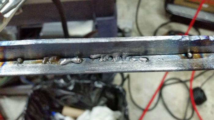

I feel like I should go ahead and expose the quality of my first weld attempt. I had no problem using the electrode to draw a puddle down a flat piece of steel, but when I tried a simple fillet weld, things did not go so well. I would describe my effort as resembling a string of poops left behind by a very sick mouse. I was kind of surprised to learn that little bits were actually welded.
I assume I should have started with a butt or lap weld? Getting into that corner is totally different from making a puddle on flat steel. Every time I thought about where the arc was hitting, I stopped thinking about the pedal, and the amps went so low I just tickled the metal. Then I cranked up the amps, forgot where the electrode was, and jammed the filler rod into it.
I decided to give up after fifteen minutes or so, to give my body a day to manifest any damage that might develop due to mistakes with my helmet and other protective gear. I don't think I did anything wrong, but I figured moderate injuries were better than severe ones.
I learned a whole lot about grinding tungsten. Three new tips so far. I would say I have the whole tungsten-grinding thing conquered, thanks to my total inability to weld correctly.
I feel like I should get some steel that's more suitable. This old angle iron is so pitted, lumpy, and scaly, you have to grind the living crap out of it to get it ready.
Maybe I'm deluded, but I really think I could do a butt or lap weld.
If there is some sort of prize available for worst first weld, I would like to enter this.

You've proven to yourself that you don't have enough puddle/filler/pedal control to join pieces yet.
Make a very pretty flat pad where all the welds half overlap the previous weld and are very consistent in width and height.
Then you're ready to try a lap weld.

Come on...you'll get it and then you'll be back here showing off weld porn. No one was born with the ability to weld. Thats' why they don't provide diapers on the pipelines (mental attitudes aside) and they have schools for welding. You'll be fine...see what happens in a few months.
I could be wrong, but I think I'm seeing a common "first attempt" mistake. It looks to me like you're trying to melt the rod into the metal.
You need to melt the metal, then add the rod.
It's really easy to focus on the arc instead of the puddle, which is the biggest problem I find with people making their early attempts.
Patience. It will come.
And make it MUCH easier on yourself! Start to TIG weld by setting your machine up in Scratch start or Lift start, whichever yours has. Learn to work the arc and filler, then when you have your torch fundamentals down, swap to a pedal. You're trying to learn so many things at once and focus on too many things. Make it simple so you can make it easy.
